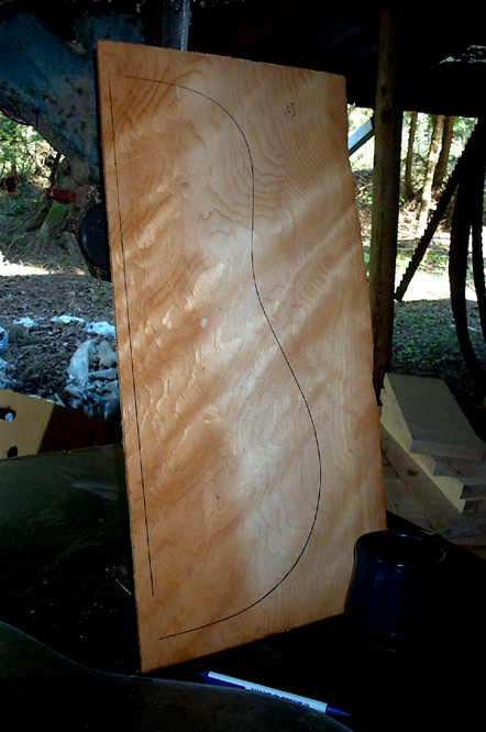

Here's a pic of a slab-sawn Curly Sitka top resawn from a billet that only
had a few inches of width, so it got slab-sawn just for grins.....
The bi-coloring is sun staining and not in the wood....
Interesting look, surprisingly stiff, but not something I'd recommend
using...
