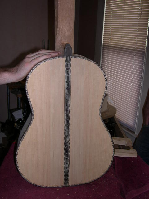

One was Cypress, with a good amount of decoration for a classical:

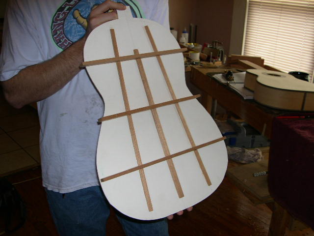

I have to show his version of Torres' paper-mache experiment. This guitar is being constructed of artist quality cardboard.

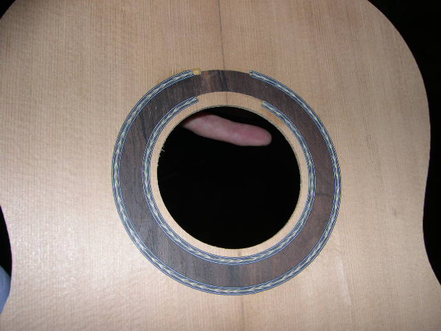

Of course, Joshua will put a European spruce top on this experimental box. And, he just "threw together" this elegant rosette for the instrument. Brazilian rosewood with his own herringbone purfling:

Joshua's rosette and backstrips are unbelievable

And let me point out another detail: notice the grain orientation in the Brazilian rosette (bottom pic). The question was raised in an earlier post which way to orient the grain in wooden rosettes. I feel that Joshua has done it the most logical--and attractive--way. Run the grain in the same direction as that of the top.
Controversial comments now concluded.

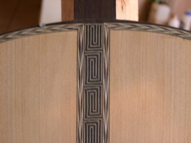

A couple questions...The Cypress with the stacked square mosaic...are you voicing and setting up as a flamenco or a classical? Killer look...when I saw a couple of weeks ago your herringbone everywhere purfling I was wondering if you were doing an homage to FE08 (Torres)...The headstock above is a dead-on match for FE01...nice
I really like that you have used some of the very Torres looking stylistic elements...including the Tornavoz.

That is impressive! I love the strip down the back (meandor?). Very
Torresesque.

Shawn - thanks. I wanted to reply to this seperately, so my other post doesn't get too long.
The guitar is meant to be a classical, and though all my guitars are lightly constructed this one is not as lightly made as it would be had I approached it as a flamenco. The main difference, besides it carrying my usual dimensions, is that the final thickness of the back is 2.7mm in the center. I've done a couple of these cypress classicals, and they've been everything I've hoped. Cypress is my personal favorite wood (well... European Spruce doesn't count, thats a given!).
One day for fun I'll build one with the intention of it being a flamenco. But with that said, I have orders for cypress guitars that I greatly suspect are for flamenco players...
A Euro Spruce top, Spanish Cypress back/sides, and a Tornavoz is where I start if I am looking to make the absolute best sounding instrument I can. For my guitars, this has proven the best combination yet. Jose Romanillos did some Cypress classicals in the 70s, but he said they were hard to sell despite that being his preferred wood, which was my original inspiration for it.
The guitar pictured, which I won't lie drained an enormous amount of energy from me (I don't have a thickness sander, which would have helped with those inlays immensely!), is something I was inspired to do because of FE08. I did the back center strip over a year ago, and am now just finishing up on the guitar (though I've built 8 or 9 others in this time). I have to have the right inspiration and the right frame of mind to tackle new inlays. And this is basically getting my feet whet in this style of inlay. I have planned a copy of FE17 (Tarrega's first Torres) and then after that an FE08 copy. Because of this guitar, I already know what I need to adjust in my inlays, though this is definitely an interpretation of Torres inlays done kind of "my" way.
An FE08 copy is a monumental task. Right now, looking forward to it - its like building a house with a block plane.

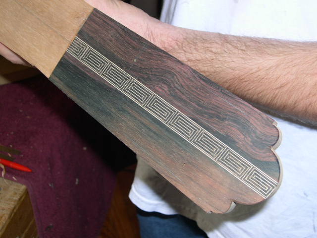

The headstock you see there is incomplete - I was about to do the slots as Steve knocked on my door. Like FE01 and others, I later added the "rope" or "half-herringbone" between the slots and the edges. I'll post pictures of the completed guitar right before I french polish it (and again after) if anyone is curious.

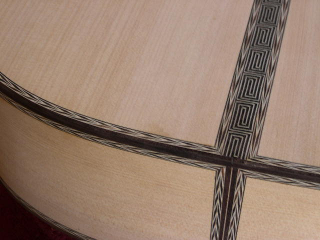

You will recognize the tail area of the cypress guitar already pictured:

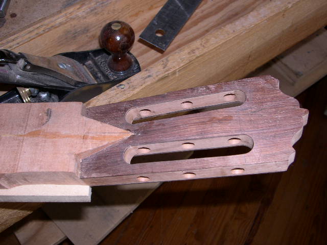

This next one is of the maple guitar's neck / head joint. A very attractive joint that Joshua makes look easy:

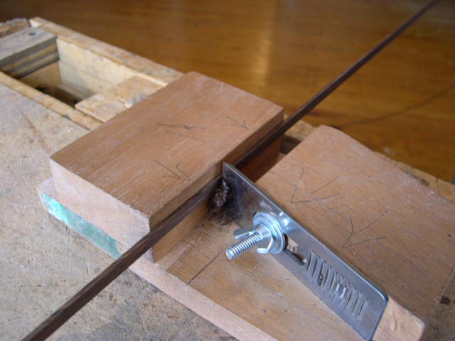

And, a nifty little jig to quickly dimension bindings and purflings. Just a plane iron, set at the angle, with a hook turned on the end of the blade:

Man, those purfling miters are SO nicely done!
