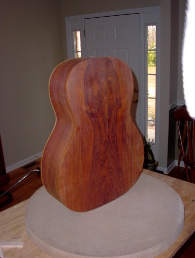

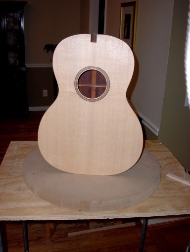

Well, here is #2 all closed up, thought I would share a few pics. It's got a really nice, lively tone, coming out of the box at this point, hope this means it will sound good strung up....can't wait to see/hear!
It's Cocobolo / Sitka/white spruce combo.....what's your experience(tonewise) with this combo?
Greg

PostPosted: Sun Apr 02, 2006 10:49 am
Hey!! that looks nice!
did you ever post a picture of number 1?
keep up with the good work!

I can't figure out how to staighten those darn pictures out before posting....help me if you can, it may save on future chiropractor bills...HeHe!
Greg
Gwaltney Guitars
PostPosted: Sun Apr 02, 2006 11:39 am
open the pictures first with "windows Picture and Fax viewer" than click on the bottom of the window on the "rotate clockwise" or counter clockwise" button! its a breeze.....
good luck

Very Nice.
Personally I LOVE cocobolo guitars. So far, 4 of the 9 completed or started
guitars of mine are cocobolo. 3 are OM's that are completed and they have
the best sound of anything I have made. Now I matched that with cedar tops
though. The one under construction is spruce Cocobolo, (SJ with Lutz 12
string)
you will love that OM cocobolo guitar. They are a bit heavy but who cares
with that sound!!!!!!   Out of curiosity, how deep is it. Mine are 4.5 at the
end block and 4 at the neck. I cannot tell how deep yours is.

Very nice, Greg. How`s about more pics? Turned 90 degrees, though.

This one is actually a 000-13 fret to the body. 3 3/4" at the neck & 4 5/8" at tail. Approx. 20 1/2" long. I'll take some more pictures along the way.
Greg

BTW, I fixed your images ..
