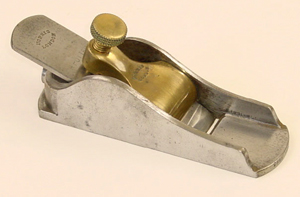

This Norris recently sold for ?1200.

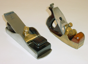

Shawn, Todd, how about these two, at the same sale:
The number 11 rosewood infil went for ?3600, and the coffin smoother with walnut infil was cheap at ?1000!
