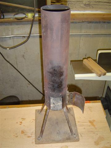

PostPosted: Sun Mar 26, 2006 1:29 am
Posts: 2356
Jay,
Here is a shot of one I used for years. It is just a pipe mounted on some legs. It has a door cut in the bottom that controls the air flow through the pipe. I clamp it to a bench, fill it with charcoal and in about 15 minutes it is ready to go. It doesn't have the convenience of propane and you need to work outside but other than that it is great.

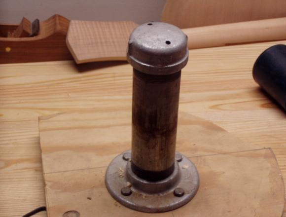

PostPosted: Mon Mar 27, 2006 2:02 am
Posts: 338
heres some photos of my pipe bender, I doubt I spent $20 bucks on it.
its 2X8 pipe nipple with a flange mounted to a piece of scrap ply, was a cutoff from a form. Doubt it needs to be so thick, but it was just laying around.

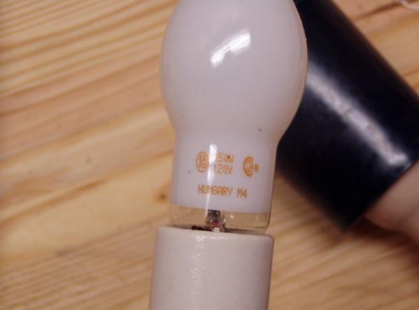

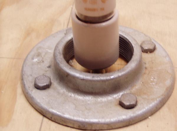

Shot of the ceramic socket, mounted on brass hollow threaded insert w/2 brass nuts to secure it. And a 150w lamp. I believe they were available from 75 to 250w.
shot of the lamp specs

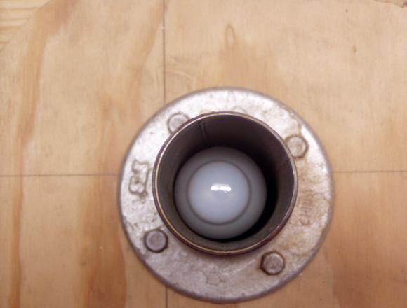

just the fit of lamp to pipe.
I'm not sure how hot it gets, but water dances on the surface, and I have bent 1/8th inch maple on it. Of course you could get more high tech with a dimmer and a temp probe.
