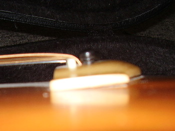

Well, here is a good example of why we cap the joint of the x-brace.
There could be other reasons why this guitar failed but I would think that most of the reason is a week joint at the cross in the x-joint. I neglected to cap the joint on my first build and well, you can see the difference in height between the front of the bridge and the rear of the bridge, also the bridge has pulled off the top.
So now I have to remove the top (want to try something new anyway) and either fix it, or make a new one.
This guitar is only 3 years old, and I noticed the dip at the front of the bridge start about 6 months after stringing it up. Well, I'll never do that again.Rod True38796.7909953704

Rod,
I believe that it is best to cap the X brace. There are many old guitars out there without it that have not had the bridge pull up/off.
Dont you think the best explanation of why the bridge came off is that the bridge glue joint was not strong enough, either from poor technique, or bad glue? Poor technique could be too much gap, surface contamination, too much pressure, too little pressure, to short clamping time, etc.
PostPosted: Mon Mar 20, 2006 11:51 am
Of course there is the fact that this is my first and most probably poor construction and application of the bridge. But.... as the dip at the front of the bridge got deeper, the bridge never showed signs of pulling off. This is why I think there is something to do with the torque of the top in pulling the bridge off, along with the possible poor adhision to of the bridge to the top.

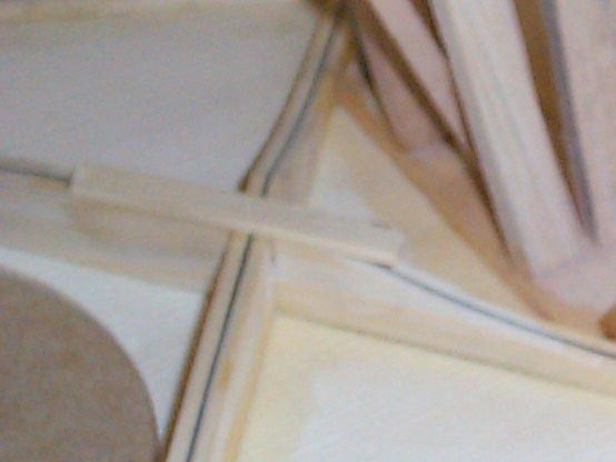

I'm not familiar with "capping" the x brace joint. Can you explain?
Jay
PostPosted: Mon Mar 20, 2006 12:00 pm
Jay, when you make your x-brace, most tend to place a small "cap" over the joint. Since a picture is worth a thousand words, I'll save the typing.
I stole this picture from Mario's web site, best example I could find.

Rod,
Could the dip at the front also be from a poorly placed bridge plate?
PostPosted: Mon Mar 20, 2006 12:56 pm
Rod, have you gotten in with a mirror to examine the joint at the X. I'm not doubting you but I'm having troubles figuring out why that would make the top cave like that. My logic says that the X is misplaced (maybe too far forward so the front of the bridge is not supported at all) or the bridge plate is misplaced so it doesn't support the torque of the bridge. I'm just not understanding why the cap would offer that much support to a torquing bridge.
PostPosted: Mon Mar 20, 2006 1:11 pm
Those are all very good posibilities and probabilities. Your all most likly correct, I guess that because I knew I didn't add the cap, I am assuming that was most of the problem, but realistically, I'm thinking there is more wrong with my work than right.

Posts: 1542
Usually when I see this it often is from a failed X brace or poorly place plate. I use a half lap joint and cap with a linen wad.

[QUOTE=SteveS] Rod,
Dont you think the best explanation of why the bridge came off is that the bridge glue joint was not strong enough, either from poor technique, or bad glue? Poor technique could be too much gap, surface contamination, too much pressure, too little pressure, to short clamping time, etc.[/QUOTE]
Steve, I think Rods point as to why the glue joint failed has to do with the fact that as the bridge rolled, supposedly as a result of brace failure, more direct pulling stress would have been applied to the very rear of the glue joint as apposed to the shear stress shared over the whole joint had the bridge remained flat.
