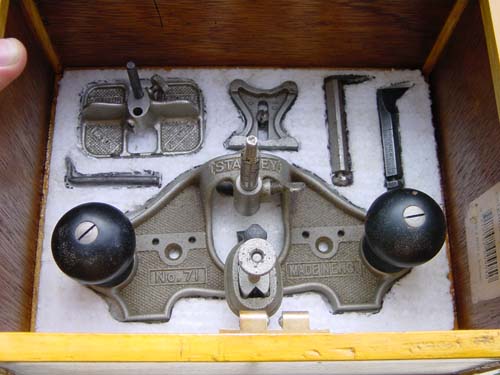

I really like Kims' Stanley router and believe it's the quietest of the bunch, but it probably won't work in a cnc too well!
I'll keep you all posted as I make progress with it, but it's not even in my possesion yet.Jim_W38798.0512615741
