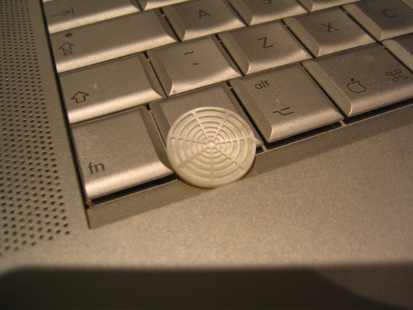

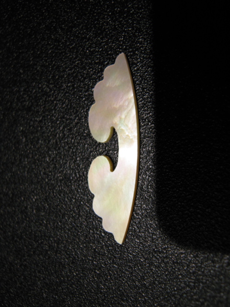

i have been doing some inlays for people on the CNC lately and just wanted to share
thats for a rosette, its one of 13 pieces in the rosette
this one is going between 11th and 12th on an existing classical guitar, it is the symbol of the subud spritual movement

Posts: 254
yep CNC can go that small,
only trouble is you have to use .010 carbide cutters, and they are like $35 a piece, they break without warning, and it is slow, that symbol took 4.5hrs to cut, as the feed rate is only 1" per minute, and is depth pass is 0.15mm, but i really get a kick out of it!!
