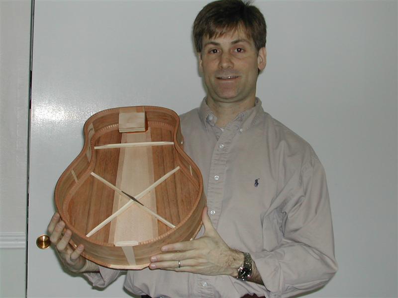

This weekend was productive! I got the back glued on. Next is the top! Enjoy.

Thanks Hesh! This is a Koa/Sycamore/Koa back. The top will be Cedar. It will be a 8 string Pin bridge Bouzouki.

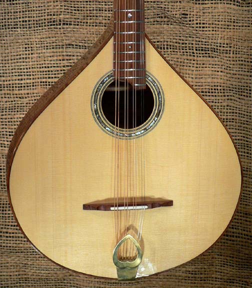

Graham McDonald's book has excellent plans in the back. He used an X latice system which produces a really nice sound. Soft & tinkly when played gently & a powerhouse when you want to get more agressive.
I'm going to build one with a standard X pattern & see what the difference is. My zooks are the "onion on a stick" flat tops rather than guitar shaped. I love the look of the traditional shape, but I bet yours will project even better than the traditional version.

I think that the book is good stuff, but I choose to do some things differently. He isn't a fan of a flat-topped instrument with a floating bridge and says in the book that floating bridges belong on carved-top instruments, and flat-topped ones should use a pin bridge. The thing I don't like about the pin bridge is that it is a lot of pressure on the top, and you need to brace the heck out of the small instrument to make it work.
I differ with him on that point, and I use a floating bridge on my flat topped instruments. I use the traditional shape, "onion" shaped as Daniel calls it. As long as you don't use too much neck angle, you won't get an un-due amount of down-force on the top and I use a regular X-brace layout with no troubles at all. I use ONLY the X-brace, the only other bracing is a spruce bridge patch right under the bridge. I've never had a top fail on me. I like the thought of a lighter-built instrument. Here is a shot of the side view, showing the neck angle.

Hey Mark, can we get a full shot of that? Thanks...
PostPosted: Tue Mar 14, 2006 9:03 am
Posts: 575
Believe it or not, I can't seem to find a photo of that one- it has a heart-shaped soundhole. But here is one with a round hole, just like it.

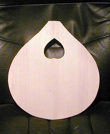

Here's a photo of the one with a heart-shaped hole, before it was finished. It's the only one I have done with this soundhole, and I like it- I should do more this way. It has a feminine look to it! <G>
