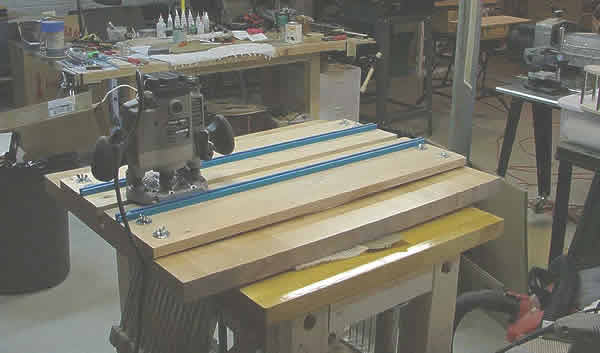

I have made a jig that I use with my router. It works dead on 100% of the time with hard woods for the backs, but tops are a little fussier. I usually touch them up with a hand plane.
However, I am interested in knowing Paul, what type and # plane are you using. I have been thinking about switching to hand jointed edges for my tops.
Here is my jig.

Brock that is a nice jig, can you explain it? I see that both right and left bookmatches are clamped down. What kind of router bit? Thanks in Advance. Nice looking setup.
PostPosted: Thu Dec 30, 2004 11:33 am
Sure. The bottom board is a 1.75" butcher block cut off. I routed a dado in it about 1" wide and .75" deep. in the center of the board. I marked a centerline in the bottom of the dado.
Then I mounted the top two clamping boards (pine sealed with shellac). They loosen and tighten with the wing nuts on each end. The bolts run all the way through the bottom and top board.
The bookmatched guitar plates are sandwitched between the bottom board and the top clamp assembly. The seam is eyball lined up over the center line and the boards are snugged down firm (not tight, just firm).
Then a router is run between the rails. I use a 1/4" spiral down cut bit in this and take about half the bits cut from each plate.
One pass does the trick.
I fussed with this set up so the cut is dead on straight. You can't get any light between these cuts and a straight edge.
However, even if it wasn't 100% perfect it would still work very well, because any in accuracy on one plate will create the mirror image of the inaccuracy on the other plate and you will end up with a seam that fits together like a puzzle piece.
I built this because (at the time) I didn't have a nice jointer, but now that I have one I still find myself using this jig because it is so reliable.

Brock, this is the best "new technology" or technique for joining tops backs, and hey, just anything. I will build one of these the next time I need to joint anything. I keep 1/4 inch carriage bolts and wing nuts on hand for this very reason.
Thank you for sharing this. I just know in my knower that this is a great tool set up.
Might I suggest you do a photoessay and drop it in the tools and jigs section of the OLF?
Great little setup. I wonder if a replaceable sacrifice strip might work well in the place of the dado for support during the cut. Might cut down on vibration at the cut? I know when drilling holes, drilling over a sacrifice board, makes a better hole with little tearout.
