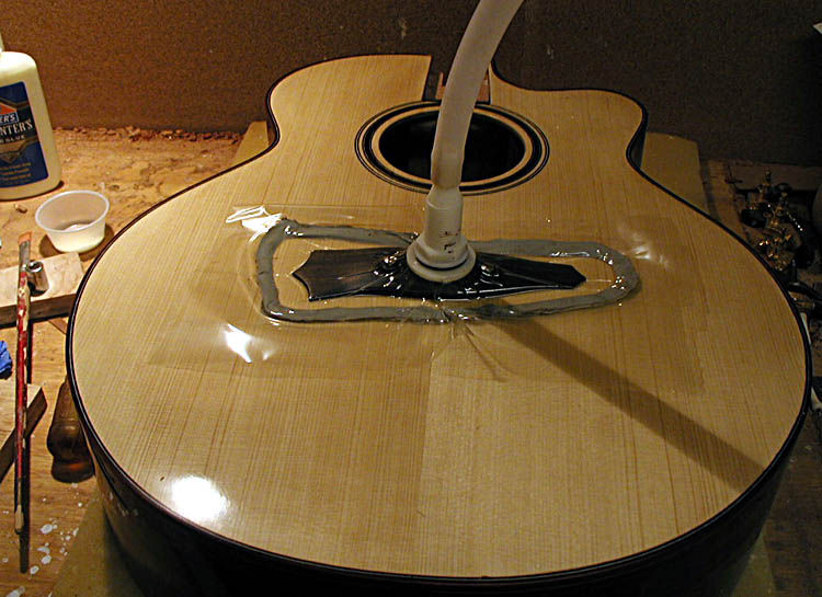

I use vacuum bridge clamping, but I did not pay the $80-some for the LMI unit. A foot and a half of sealing mastic strip (reuseable), a small scrap of nylon vacuum bagging film (we use both of these vacuum bagging wood/epoxy kayak hulls) and a $4 plastic fitting to attach the hose to the film, and that's it. Very simple and works great.

Here's a pic of my clamp. I didn't bother with the protective plexi top. The connector is a short piece of 1/4" OD copper tubing epoxied into a hole drilled in the frame. The vinyl tubing is a tight fit, but if you warm it up with a lighter or boiling water, it'll slip over a bigger tube easily. When it cools it tightens up & no clamps are needed.
