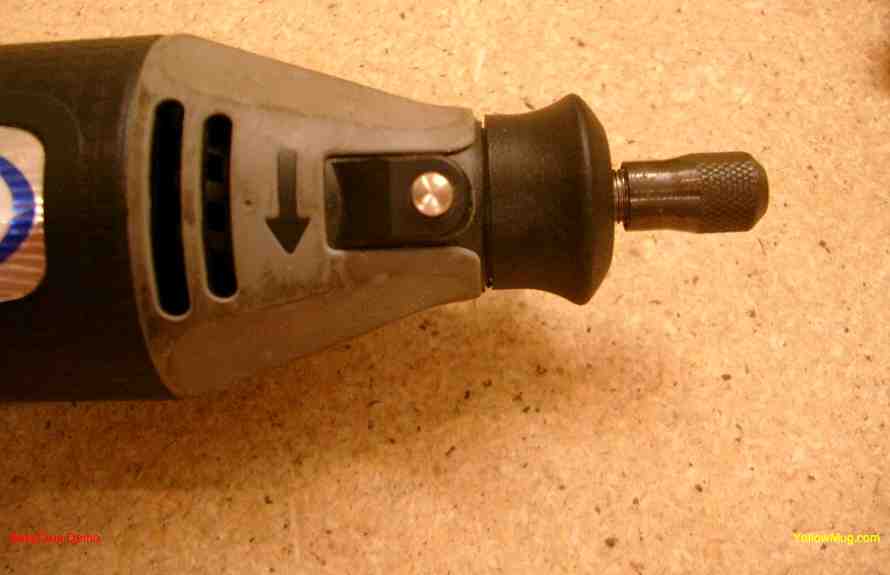

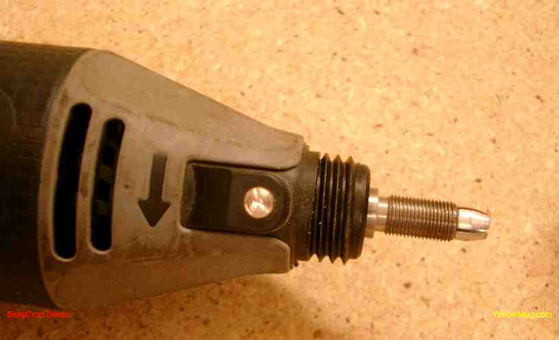

Rich the Dremel in your photo appears to have the screw on collett required to fit into the Stewmac router attachment.
Can you post a close up pic of the front end of the tool?
Cheers Martin

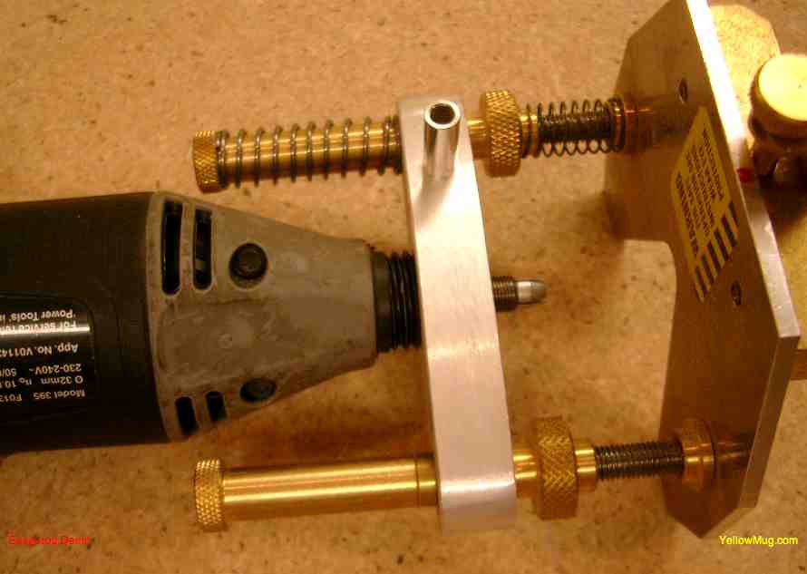

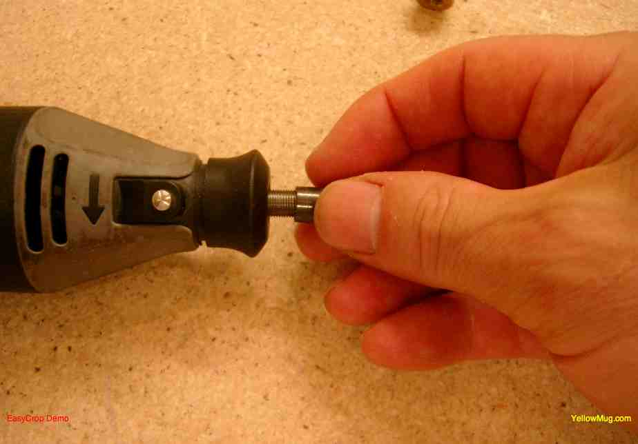

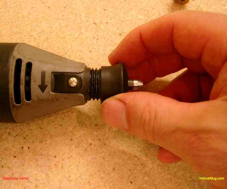

Rich,
See pics below of my Dremel being fitted to Stewmac router attachment.
Cheers Martin
