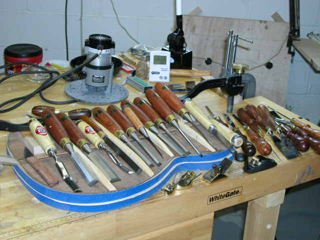

Interesting so far. Several reasons for me.1. A bit of a purist.2.Tactile pleasure(actually aural too)3.Less risk of instant disaster.4. Not doing this for a living so have the luxury of time.5.Have so many planes I must use them to assuage ownership guilt.6.There are some things I believe are best done with a handplane(eg. preliminary brace shaping,champfering edges). Keep reporting guys,Thanks.MT(Letterman-like humor(our)ous TOP TEN?)

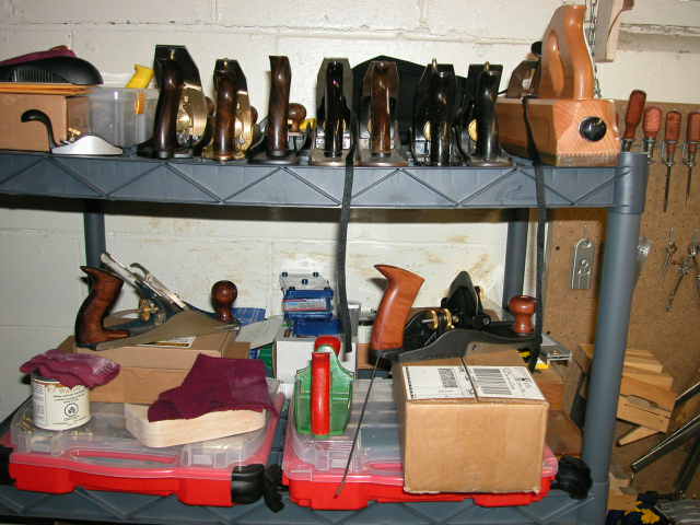

Posts: 639
I think there are about 10-12 more not in this picture. See what I mean about guilt? I'm just as awful about chisels
