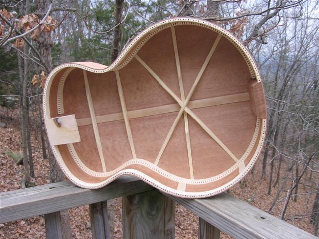

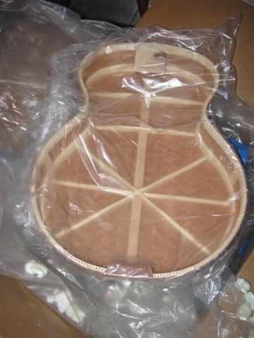

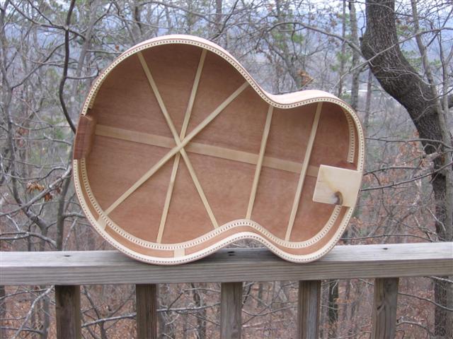

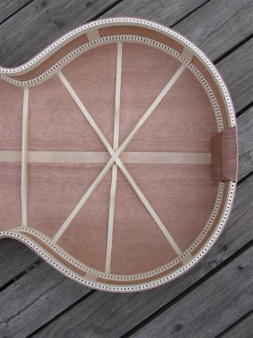

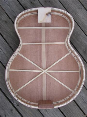

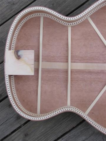

Paul Woolson finished up the back, sides, and linings, plus neck block with extension. Here is the result, he asked me to take a picture.
Great job Paul and Lance! Shop temp and RH posted above, tomorrow the top joins the party! Get ready Brock, here it comes, case or not. That was one sturdy box, Paul. Bruce Dickey38784.6642939815

Paul where are you getting your aspen linings? Are you kerffing them or do you get them pre kerffed?
PostPosted: Wed Mar 08, 2006 9:25 am

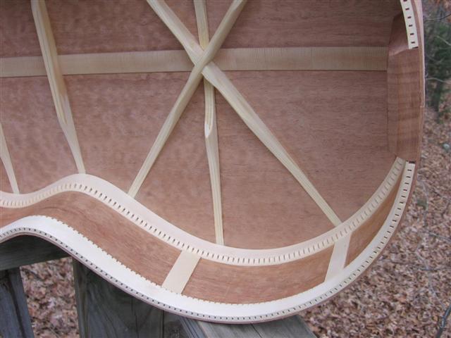

MP, I make them. It's an extremely labor intensive process to make this style of linings. First you need to mill the strips to 1" x 1/4" x 36" . Then I run them through a moulding head cutter to put a 1/4" round over on the top. Then they go through the table saw standing upright to cut a "shelf" to accept the cap strip. Then kerfing which isn't the most exciting thing to do. Then the cap strips are cut 1" x .060" x 36". It's these cap strips that make the linings unique. Because they are seperate, they make a sandwich of the whole system which makes them very rigid.
Bruce, are they rigid?
PostPosted: Wed Mar 08, 2006 9:44 am
Aaaaaaaaa It is not really reverse Kerf it is forward kerf that is capped ....Cool
PostPosted: Wed Mar 08, 2006 11:38 pm

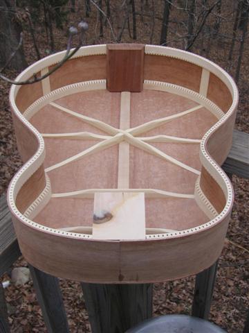

They are very very rigid. As seen in this photo from Week Three, the mold is only used during end block and linings installation and no longer needed to apply top and back plates. Great design.

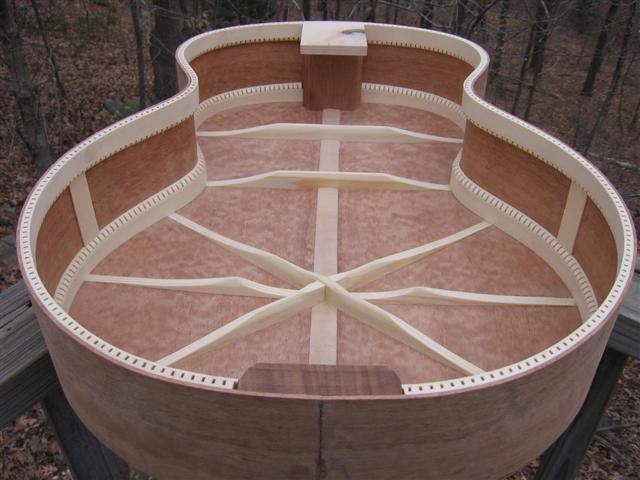

That is fixed and ready for the top. Good Old Hide Glue and some Klemmsias. I hear that boat calling my name from here. Aaron's and this one, get topped today, yippee!
PostPosted: Thu Mar 09, 2006 4:10 am
That's a gap that I let pass, assuming that the mortise would cut it out anyway. BD found that the sides slightly hung up on each other which is why it didn't close in the first place. He made a saw kerf and got 'er closed up just fine.
Nothing like having your mistakes posed on the internet.
