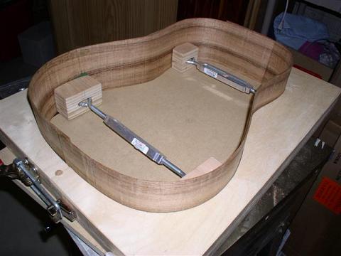

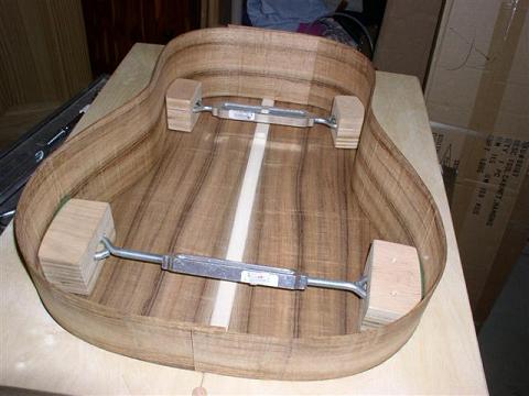

Here is the Black acacia Dread bent and put into a John Hall dread form.

Try this again. Looks great Lance. I am just getting started on an Om using the Balck Acacia I got from Don. I plane jointed the back and top last night. i hope to bend sides this weekend.
PostPosted: Thu Dec 30, 2004 3:34 am

Lance,
Great looking rim! A couple questions:
Is Acacia open or closed pore?
How easy is it to bend?
Thanks!
Jeff

JEff, the Acacia bent like butter! I thinned the sides to .085 and could hardly feel any resitance when bending the lower and upper bouts, ill have to give it a closer look to see about the pours, but i suspect there open.
Thanks BTW
L

PostPosted: Thu Dec 30, 2004 4:16 am
[QUOTE=Jeff Doty] Lance,
Thanks!
Jeff[/QUOTE] Jeff I would rate it at a medium closed pore wood. you will need to fill the pores but they are nowhere as open as IRW. On Koa and Black acacia I cand fill a back and side set with two pbutt of Z-poxy
