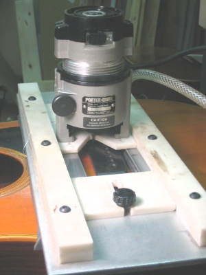

I don't do much building anymore, so binding slots are not a common use
for my laminate trimmer. My 310 is more or less permanantly installed on
my saddle routing jig, for which the power and steady bearings give me a
cleaner cut that any other trimmer I've tried.
