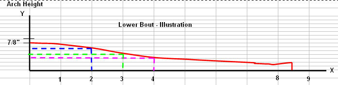

Starting with the Benedetto templates (or your own thoughts on appropriate arch) I draw on graph paper a set of arch profiles for each the upper and lower bouts, waist, centre of the waist to heel end edge and length of the body. Illustration below is for the Lower Bout....

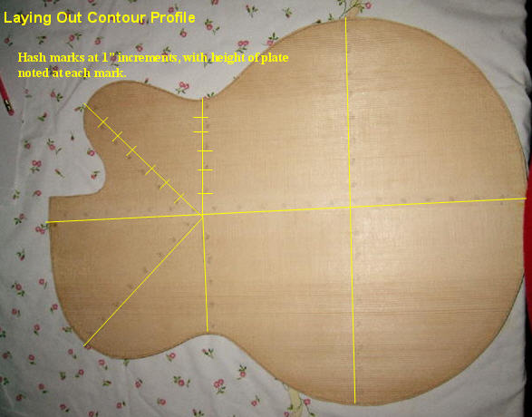

Next I take each of the above described arching templates and plot in one inch increments along the vectors shown in yellow....
________________________________________________

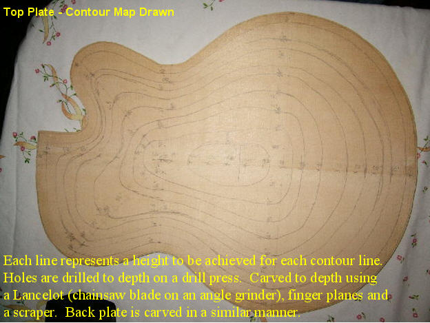

By eye I join each of the marks made plotted on the top from the above picture, creating a "contour map". On each of the lines I mark the height of the arch.
Using your drill press and depth stop, drill 1/4" holes to the prescribed depth on each of the contour maps (sorry I don't have a photo) but the Benedetto book has an illustration to that effect.

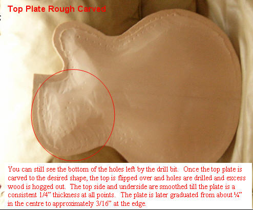

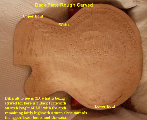

Once done drilling -- I get out the angle grinder fitted with a Lancelot and start hogging away stock till I only see dimples from the drill holes. Finishing up (on maple plates with Angle grinder fitted with 60 drit paper) using finger planes, scraper, orbital sander...etc. Picture below shows a top and back plate after I've put away the Angle grinder/Lancelot.
Anthony Z38771.4091782407

Mike, correct you are if you follow the arching in the Benedetto book, the top plate has an arch of about 1" measured from top to bottom or 13/16" if measured from the apex of the arch to the top of the plate. Like I said you can use the Benedetto arching templates or make your own -- the rough drawing shown in the first picture would be for the back plate.
