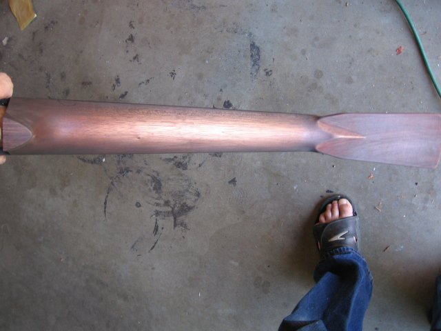

Thanks James those pics are really nice. I went with 3 colors of stain and feathered them in as best I could. I think it is going to look OK. I'm trying to upload some prelimnary pics.LarryH38760.7071412037

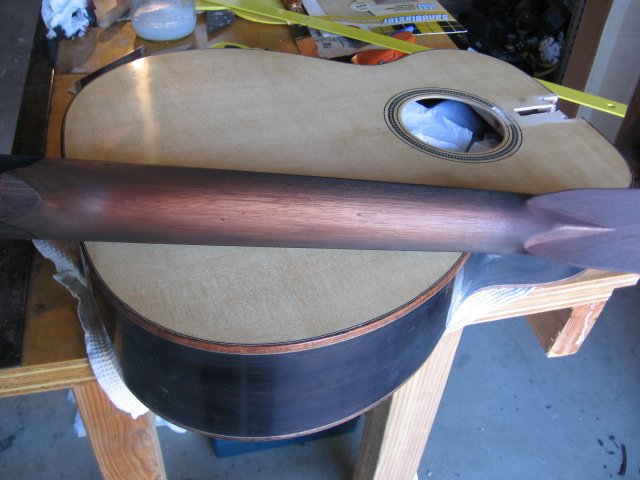

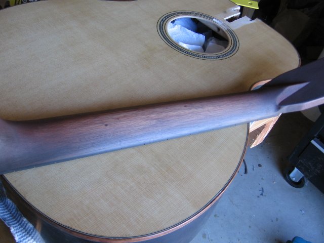

I tried Olympic oil based stians in Mahogany, Dark Ebony and Mocha Brown. Haven't sanded yet, just wiped and blended. Looks pretty cool. I'll put some finish on and check in again.
Larry

Larry,
The neck looks fine. I think it will look great when you put the clear on it.
