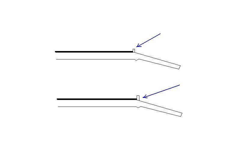

I've seen the nut been placed either right on the neck or at the end of the headstock . I always put mine on the neck but was wondering what the rest of the guys do and maybe someone has some input to say about it and why!
PostPosted: Sat Jan 14, 2006 3:50 pm
Figure 1...the fewer angles I have to grind on the nut, the better...I lose too many fingernails/tips as it is...

I've always done it as in Fig.1(top) The one I'm currently working on will have it as in fig.2 (bottom).
No real reason just thought I'd try it a different way. I agree making the nut will be a bit more involved.
Uh oh! Looking at your drawings, I just thought, Hope my nut blank is tall enough...

Personally, I like it as in the lower drawing. More trouble, but I like how the bottom of the nut flows with the headstock and the top of the nut as slopes towards the tuners.

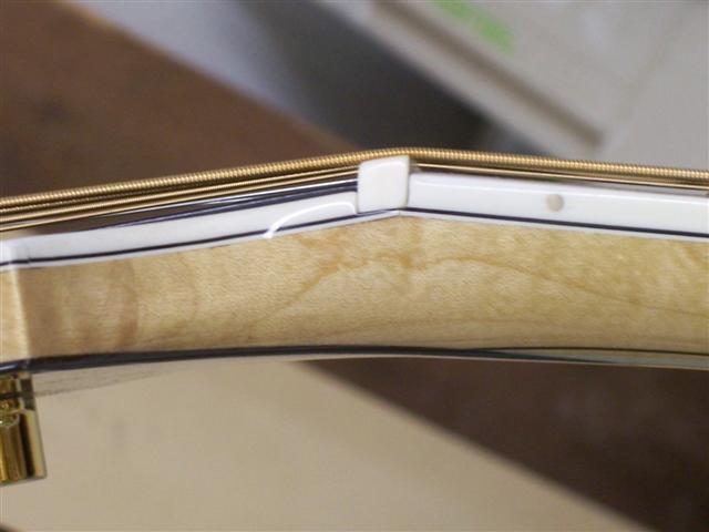

I do my archtop nuts "Bennedetto" style-Kind of hard to explain-you have to add a wedge shaped piece of wood to the neck to continue (and extend) the plane of the head in order to get the side purflings from the head to the neck to flow continuously-check out Bob Beneddetos book-even if you are building flat-tops-it's one of the best out there.

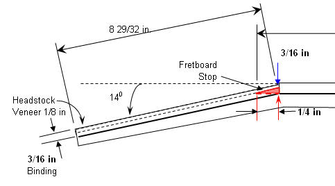

Brad I do it the same way. Maybe this diagram helps to explain the fingerboard stop.
If you look at Peter's first diagram, where the nut is seated you glue on a small strip of wood, then sand it to the angle of your headstock. Cut the channel for your nut as Brad has shown. It's a nice touch on bound headstock guitars.Anthony Z38734.4173611111

Thanks for doing the drawing-I don't have enough computer prowess to do a sketch
PostPosted: Tue Jan 17, 2006 8:28 am
Thanks a lot Anthony, easier to understand!
