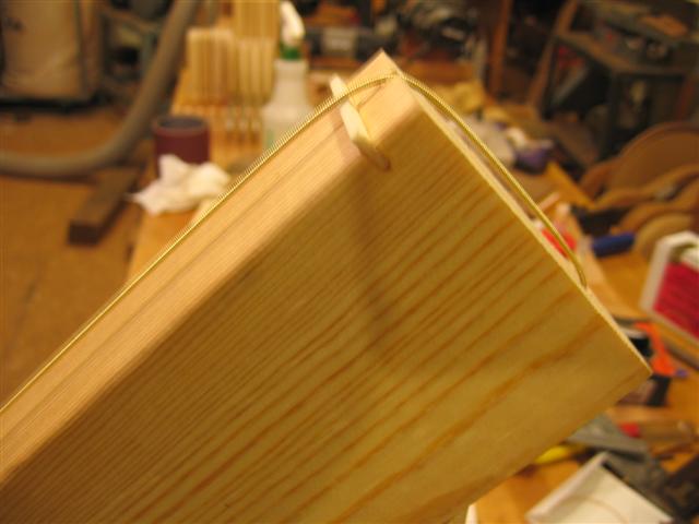

Okay, don't laugh, my 13 year old needs a science project done by weeks end. Here is what we've come up with, I just feel there has to be something better in the way of Science, than just proving the pounds of force pull on a guitar top, tuning six medium 80 / 20 Bronze strings to pitch. Open for suggestions from one and all.
The hypothesis: An attempt to show that there is more than 100 pounds of force but less than 200 pounds of force needed to tune an acoustic guitar to pitch. Lame I know.

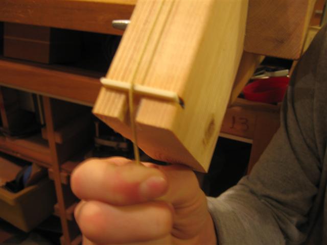

Here is a pic of the jig. It traps the ball end on the frame, comes up and over two super glued bone nut/saddle arrangements, then down to awaiting weight holder which isn't made yet. You add weight until the pitch for that string is reached and record the weight amount. After all six, you add them together to get the total force. Now, is this really science or not?
Anyway, as you can tell, we need help.

Have you thought about a wheel or pulley at the lower end to eliminate friction? Might make a difference, but then again, might not.
Pat

Pat, That is a good idea. We simply made an oversize groove in the bone nut, plus we graphited the groove with a pencil. But the pulley idea is a good one to eliminate the drag especially in the larger wound strings.
I wish we had some formulas for the force created by the weight and the stored energy.

Surprising Results, who knows how the stringmakers test the tension required by their strings? We got way more tension on each string than the manufacturers say is required.
An amusing note, we were about 1/3 done with testing, we started with a set of Martin Mediums, then switched to D'Addario Lights for that guage. Printed right on the back of the package is the tension required to tune each string! No kidding.
We are glad that we tested though, my son, and I for that matter were blown away by what we found. Here are the totals.
Light Guage 202.5 lbs
Medium Guage 227.5 lbs
Heavy Guage 271.9 lbs
The heavy guage exerts 69 lbs more pull than the lights.
The medium guage exerts 25 lbs more pull than the lights. That is a lot of tension.
These tests took hours to perform. I was proud of my son's tenacity to stick with it. Now for some incredible individual string reads.
We had one anamoly, a .045 medium A string that required 48.4 lbs to tune it to pitch. It didn't fit the pattern of the other strings, so we retested using another .045 medium A string, that one while still high did drop six pounds to 42.2 lbs.
I guess for it's size, we were most amazed by the G string of the medium set at .026 guage, it required 46.2 pounds of tension to pull it to pitch. No wonder those things really zing when they break. We also found out that, that particular string, has a .013 inner core, the same as a medium high E string, .013.
So that about does it for testing. Pat Foster is probably right, we should have used a pulley. I'd love to know how manufactures arrive at their numbers. I'm sure our crude setup, had something to do with our higher numbers.
Not only did we test a bunch of strings, we made a memory on my son's day off of school. His brother drove 90 miles from a neighboring college town to bring him a set of heavy strings which are hard to find by the way. You have to either special order them or buy them as individual strings, which is what we did.
Okay, the two strings tied for the most pull, the heavy D and G strings weighed in to pitch at 57.4 pounds of force. We used a piece of Romex, an old weight-lifting set, a bolt which we wrapped the string around and bolted the weights too. Time consuming, and made a loud crashing sound on two strings that broke in process. Watch those toes! We considered the fishing scale inline, but decided that the scale was too small to read accurately.

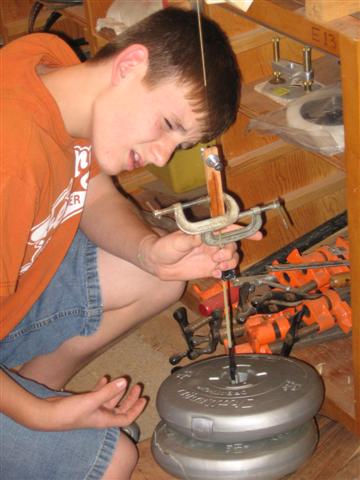

Bruce...just a thought...in the pic where your son is tensioning the wound string. Does it matter that the string is held on the unwound leader...or would it be more appropriate to clamp on the wound portion?
PostPosted: Tue Jan 17, 2006 9:10 am
Thanks guys, Gee JJ, I don't have a clue. The Heavy set were made up a string at a time in a distant city. Some of them were barely long enough to get hooked up as it was. So, while we were attempting accuracy, I'm sure there are factors such as this that make a difference in the real world.
You'd think the tensions would be uniform as you go from .o12 to .014 to .016, but as we went we found some strings that actually went out of bounds either higher or lower than we expected. We tried to guess each time based on data we'd already collected on how much weight we needed.
Fortunately, only once did we put on too much weight to start with, usually we were four or five frets low and could inch our way up. One time out of 18 we were a half semitone over. I think the fact that our setup required a 45 degree break angle to the weights, that may have caused our readings to be a bit high.
To repeat the project would be to play with that angle and possibly install a small pulley to eliminate that issue. We had fun and learned which strings to look away on, as we tune...... grin.
