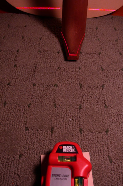

I forgot who had this idea, but it is great. Using one of these laser levels.
you can follow a straight line up and over things. In this pict, I am
preliminarily setting the neck straight. You can follow the red line al the way
to the headstock veneer. I just placed it at the end block and made it follow
my pencil line on the body. It is an awesome trick.
Andy

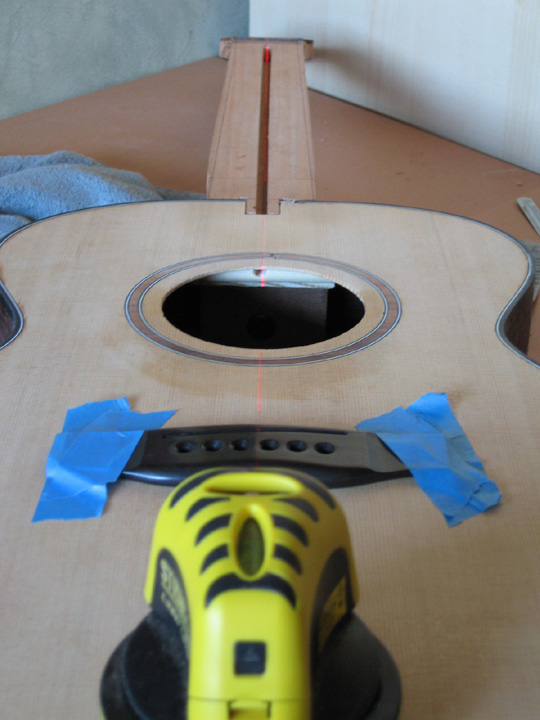

Hey Andy, my first post on the forum was about finishing my first guitar and using the laser level to sight the neck. It's also great to center the bridge as well - just place it on the neck at the nut and center the light on down the center of the neck and voila.
Fun stuff.

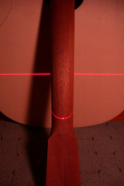

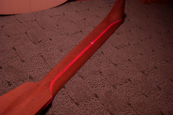

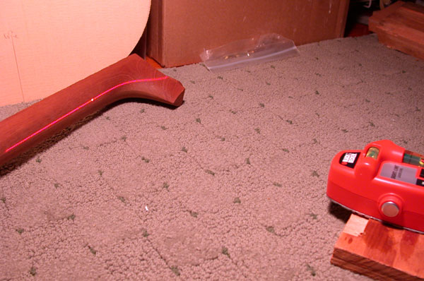

Joe and all,
Here you go.
In these top two, I use the laser so that the angle of incidence is fairly shallow, and rotate the neck to see how the light plays on the surface. If the surface is wavy or inconsistent in its curves, the laser won't move over the surface at a constant rate. Sort of like a car with poor body work on its sides, which wave at you as it goes by. In the lower of the two shots above, a constant width of beam along its length means the curve of the profile is consistent.
These bottom two demonstrate how the laser helps check for symmetry. If you move it up and down the heel and note how the curve changes and whether it's symmetrical, that can tell you a lot. Of course, I still use the eye and touch too.
BTW, this neck is not my work; it came from Martin, thus the dead-on CNC level of accuracy.
Pat
