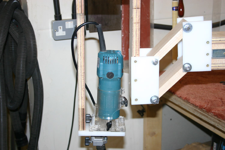

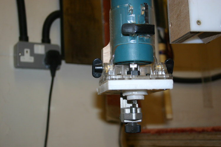

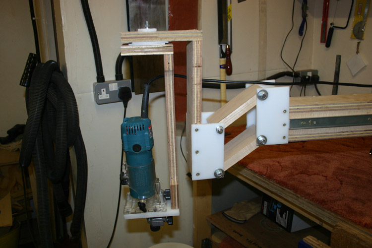

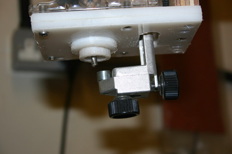

A couple of you have asked to see pics of my adaptation of the Williams/White Binding Jig.
The same as Daves this is intended for when you want to use a Trimmer with a bearing.
Most of the Detail is the same except the Router Carraige, Daves swivels at the bottom, mine at the top.

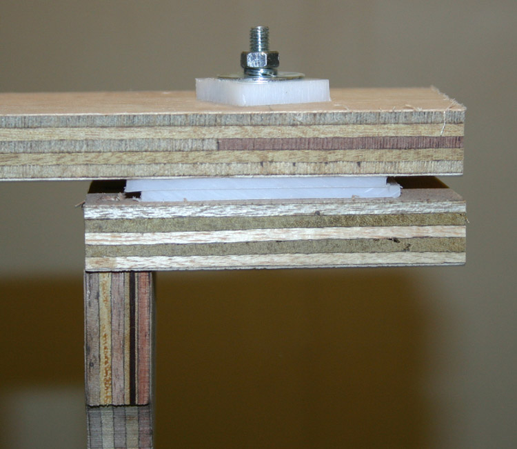

The next one shows the top bearing which is two pieces of PTFE.

THe other advantage of a side bearing Guide is You can use a Downcut Spiral if you wish, Colin S told me to try one for binding and purfling channels, they make a really clean cut, and minimise the possibility of any tearout.

    I must pass on some info about that adaptation so if I seem like the devils advocate I am not . I just want to pass on some things I have learned through failures. You will learn more from a failure than a success so I hope you don't take this as a personal attack. As a machinist I build jigs and repaired tooling for aliving.
     If you use a pilioted bearing set the roation of the router isn't needed. In fact the pilot fixture is not very accurate as you have to be perfectly square to the bearing for the depth of cut to be what you want.
   There is another weak link here that scares me , and that is the way the router is mounted. All the force is on the edge of the verticle plate. That is a weak link and when it fails you won't have time to protect the instrument. The safety factor here needs to be addressed. The load should be looked at so you mount this so you have good support .
     I used that method a few times and gave up as the set up time and results were poor at best. I think most of us will agree that once we finally broke down and purchased the pilot bearing set we wondered why we waited so long in the first place.
    I think the Stew mac PN 1298 is one of the best sets on the market for this operation.

Sorry to be a bit dumb here but what do you mean by all of the load is on the edge of the vertical plate ?
Do you mean all of the weight is taken by the back edge of the part the router mounts too ?
If it is this my thought was that when in the cutting position the load is shared by the bearing surface resting on top of the guitar.
Thinking about it a bit more I could add some diagonal straps accross the corners and under the plate ?
For me using the guide bearing is not a point of economy but one of versatility, I like being able to use the down cut spiral bit, I'm not keen on the straight cutter method the pilotted bearings use.

A couple of questions though. If the sides aren't perpendicular then the pilot bearing won't compensate and make the cut the right depth and width - both this and a router follower will give the same imperfect cut won't they?
The mounting of the router and it's bearing point (at least in my adaptation) is the same as on the Fleischman/Williams jig - I just added a Lazy Susan bearing. Do your failsafe concerns also apply to the original design?
You can just use pilot beaings but there were 2 reasons I did my adaption. I have large domes in my tops and backs (around 14-15' each) and have designs with pretty narrow waists and tight curves. In order to get uniform depth and width of cut of the binding channels around the waist and upper bouts you need the "donut" guide to be as small as posible and as close to the guitar edge as possible. The pilot bearing has to keep the same relative angle as you go round these curves and it would be almost impossible (I think, but I could be wrong) to keep a small "donut" on the surface edge. As you go round the waist curves the wider donut will index off a point too high on the top usually meaning the cut there is not deep enough and too shallow. Being able to swivel the router around these curves means that you can follow the top edge almost exactly with a very small bearing "donut".
The second reason is I like the freedom of being able to use just one router bit and set depth and width of cut using the Laminate trimmer adjustments. This gives me pretty infinite freedom in the binding and purfling designs I can do without having to have a set of pilot bearings.Dave White38733.2030208333
