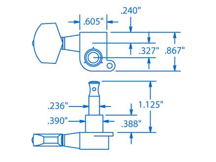

I use a 25/64" bit, its slightly smaller than 10mm and slightly bigger than 3/8" (which requires reaming doesn't it). The 25/64" bit gives a nice snug fit on Schallers.
Here is the technical drawing of the schallers off Stew-Mac's site.
Note the diameter of the post. 0.390" The 25/64" bit is the closest natural hole you can drill to match.Rod True38735.6461226852

... Right-on Rod!
25/64 th's it is then. Thanks for taking the time to present your case so unerringly...
