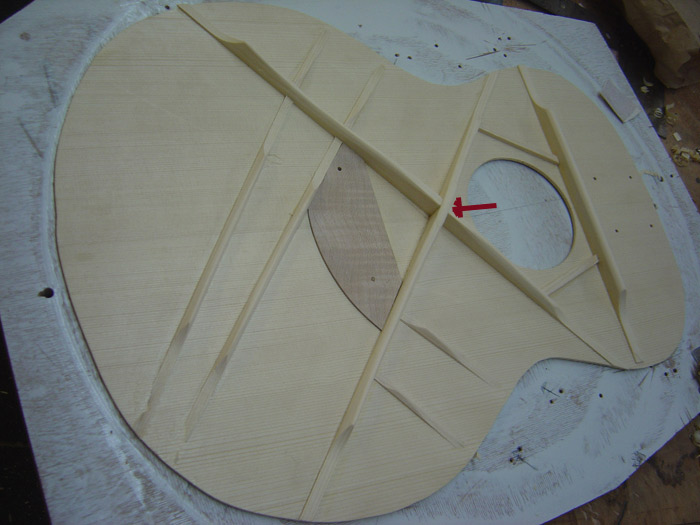

PostPosted: Mon Jan 09, 2006 11:40 am
   Somogyi advocates caping the X brace. I just put a little Madagascar cap that came from a fingerboard cut-off on my first. Looks pretty cool, if I do say so myself...

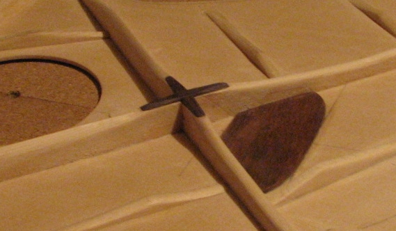

Here's a pic of my x-brace cap.

PostPosted: Mon Jan 09, 2006 2:52 pm
Posts: 552
larry;
Alain's cap in the picture is (to the best of my knowledge) atypical. Normally it is not an X but a single piece glued across the "open" section of the cross. (across the cut lines). Some folks use a disc of wood which ties the entire X together.
