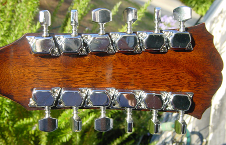

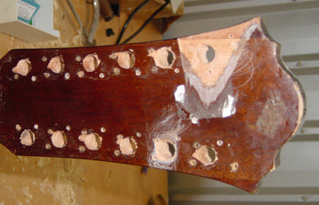

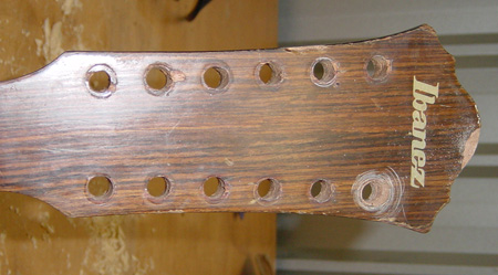

If I payed myself, I guess I would have been better to pay $28.00 for a set on-line, good thing I am cheap Another example, I had to repair a 1981 Ibanez 12 string after a PO had attempted to replace the original tuners with a full size set of M6 tuners.
Not only did these over size tuners throw the balance of the headstock way out, it would appear from the attached images, they also required the use of a rabid ferret to re drill the post holes.

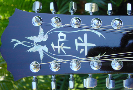

Any how, it was obvious that after re-shaping the headstock to get rid of the damaged timber, and repairing and re-drilling the over size post holes, this thing would need a headstock overlay.

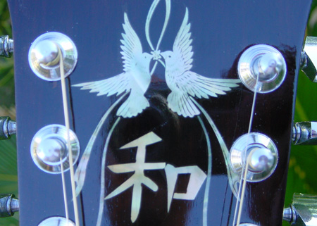

This is were our friend in Taiwan comes in. $9.00 got me an inlaid rosewood headplate. I can confirm that this was no overlay, the graved gold MOP may well be thin but, it is without a doubt inlaid.
The "only get what you pay for" factor lay in the fact that the rosewood into which the shell had been worked had not been machined flat before work commenced, so there were a few dips and wallows that needed to be levelled out.
This required a little work with a scrapper to put right, which did unfortunately decrease the definition of the graving. But all said and done, as you can see from the photos below, things turned out OK.

Kim, stunning repair, very creative. Any idea what the oriental characters say? The doves are very artistic. Great job.
PostPosted: Tue Jan 10, 2006 1:36 am
Bruce, thanks for the kind words. I have absolutely no idea what those symbols mean, I hope it is not ofensive...then again that could be a lot of fun just as long as it's not about me Mum Can anyone here help with a translation??? That would be cool
