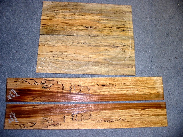

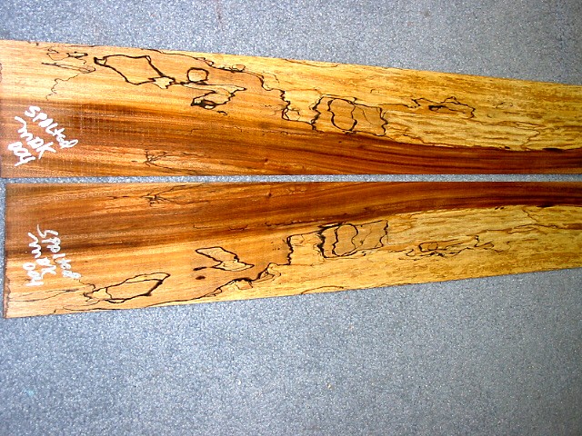

Okay, here's the spalted makore
pix~
the sides have a coat of shellac. I like em a little darker like this. Maybe even a stain, but has anyone tried this? I suspect it will mottle a little (or alot) but that may accentuate it further...could be cool.
This is all I have to "experiment with" so any help is appreciated.

Oh man, I would SO use the Makore! Since this is a non-com build, go ahead and indulge your whim.
That's really attractive.

Thanks!! Beautiful stuff!! The light color is sapwood for sure and the spalt looks to be solid with good wood fiber integrity.

Terry I would build with the makore seeing as it is not a ommission. Go ahead and have some fun. Makore sometimes called African Cherry is a fine tonewood. One word of caution: some people can have an alergic reaction so as always wear protection when sanding or sawing. It affects my nose and throat. No skin reaction. I would also use Z-Poxy for filler. I'm really not sure it's sapwood. The lighter color also appeared in the middle of 10 -15" wide boards which is not a likely place for sapwood. Some of the wood was punky and ended up in my wood burning stove. The sets I cut were nice and solid. Bobc38726.2438541667

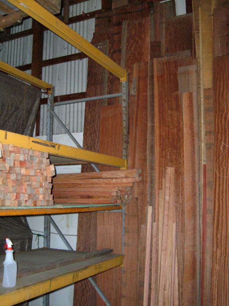

The makore timbers are the tall red ones on the left. 15' tall and some are 21" wide fully quartersawn.

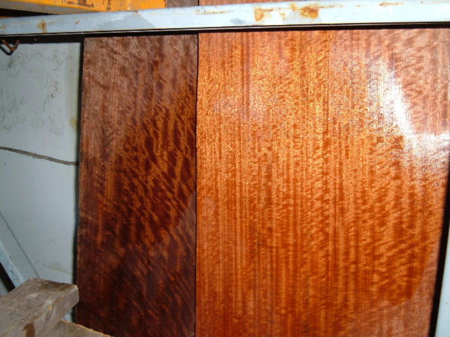

These are two figure types of several I've seen in makore. Not pictured is fiddleback figure. I'll have half a dozen sets or so at GAL. It's high in silica content and dulls tool edges quite readily, but I use only carbide tipped saw bands and jointer spirol inserts so it works fine in my shop.
Bob, I certainly wouldn't disagree with sap vs. heartwood because it's your wood for sure, but I've never seen makore heartwood spalt like that. Makore heartwood has high silica content which makes it pretty darn impervious to fungal attack. I have seen pigment colors from pale pink to wine red in makore and only have a couple timbers with sappy edges. It's beautiful stuff none the less.

so this stuff blunts tools a little? The spalting is solid and not punky, but it's probably softer than the darker brown areas.
The tap tone at this point is not impressive, but it may change when thinned down a little.
