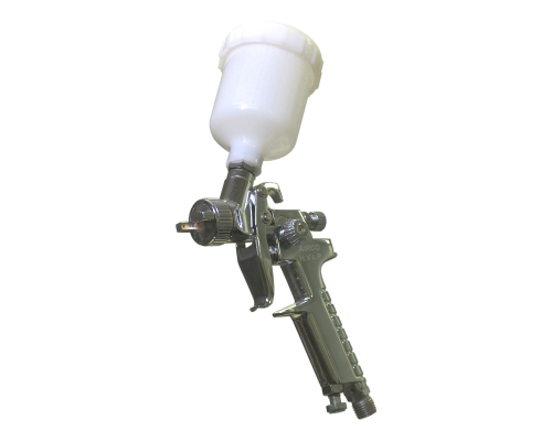

PostPosted: Sun Jan 08, 2006 7:22 pm
Here is the gun that I have, works very well spraying shellac and laquer (this is all I've sprayed so far).
This is a Canadian site with the specks on the gun. The cost is good too.
PostPosted: Mon Jan 09, 2006 1:03 am
The gun Rod shows looks pretty much the same as mine. Mine is a Porter Cable brand and usually retails for 80-90 bucks. I just use a small PC compressor with a water trap and a filter and regulator on the gun itself.
