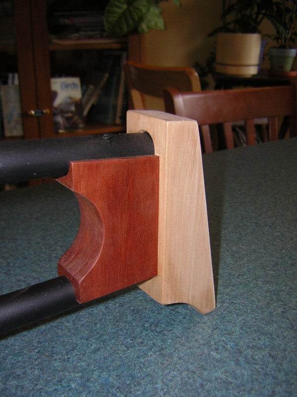

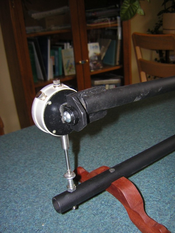

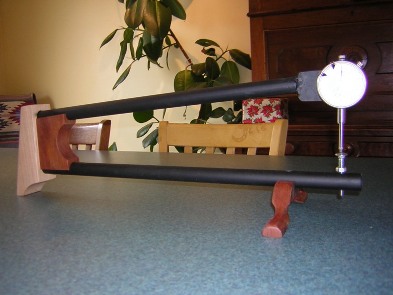

Here is one that I made using 1/2" id black pipe, a bolt and some scrap mahogany and maple. It works great!
Although I welded (I use that term loosely I should say 'glomed') on a piece of trimmed angle iron to attach the dial guage I was thinking that you could just cut a hardwood plug for the end of the pipe and 5-minute epoxy it in place and attach your guage to that.

There is a tab on the back of the guage I have. You can get these things almost anywhere for 20 bucks or so. Grizzly is an option for you, I think I boaught mine at a local industrial supply place.
I drilled and tapped the steel angle iron to attach my guage just because I hadn't done a lot of metal work and wnated too. But I think that you can just add the wood plug as I indicated above. I added the bolt to the bottom just in case I ever wanted to archtops, which I do!, so that allows you to get a 'shaped' plate into the guage which a lower flat surface won't allow you to do. Also, I can adjust the bolt to zero the guage, which isn't entirely necessary but I am a bit that way...

PostPosted: Sun Jan 08, 2006 7:47 am
Here's the pics
Hope they help!

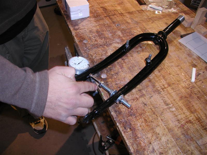

Here is probably the simplest way to make one if you have an old bicycle laying around:
This was made by one of the members in the CO Luthiers group. Very ingenius. Enjoy!

Thanks Shane! That clears thing up a lot.

Tracy, that is very clever! I like it!

Thanks fellas, there are some great ideas here. I think I might actually steal the fork off an old bike, at least until I get more time to make something a little prettier.
