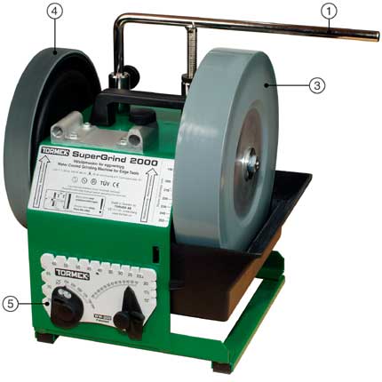

PostPosted: Sat Jan 07, 2006 2:47 pm
Posts: 993
Check out tormek.com.
Here's a pic:
PostPosted: Sun Jan 08, 2006 11:46 pm
   WOW! Now that looks serious! I'll bet it's a lot more fun to use than my cheap guide from Home Depot!!!
