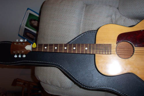

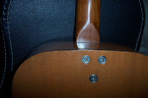

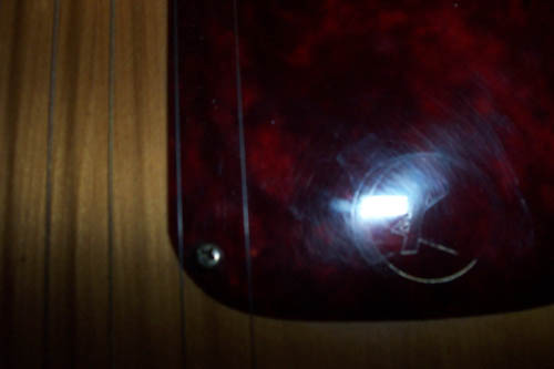

Hi everyone, need your help identifying this guitar i bought from a guy . That thing has got no serial number, no brand name or logo whatsoever and it has been built or repaired by some construction guy, cuz it's got screws in all the wrong places. There seems to be a fainting gold letter K on a screwed PICKGUARD. 3 screws at the end of the back near the heel! And for the bracing, when i put my hand inside, to feel, they were cut square. Around the soundhole, there is tortis and used it for binding too. For 25$ what can you expect huh? That thing sounds loud though, oh and there is a very tiny sticker at the back of the headstock and i'm reading
Drouin Music Bar, Timmins Ontario, so maybe Mario could pitch in as well!

Looks like an old Kay import, from the '70?

yes, it's a Kay. It probably has a solid top. They were over-braced, but the wood used wasn't bad. It's too bad that you got a bolt-on neck because the older ones used a standard dovetail.
I've actually rebuilt quite a few of these, and old Harmony guitars too. They turn out like a pretty good 000 if you take them apart and re-brace them properly, surprisingly good. They were good learning guitars for me, I bought them cheap around town and on eBay and then I'd pull them apart and rebuild them. I realized after a while that building a new guitar wasn't that much more work!
But it is fun to break out an old Kay or Harmony at a jam or something, where folks are sitting around with expensive Martins or Taylors, and the old guitar sounds as good or even better than the others!

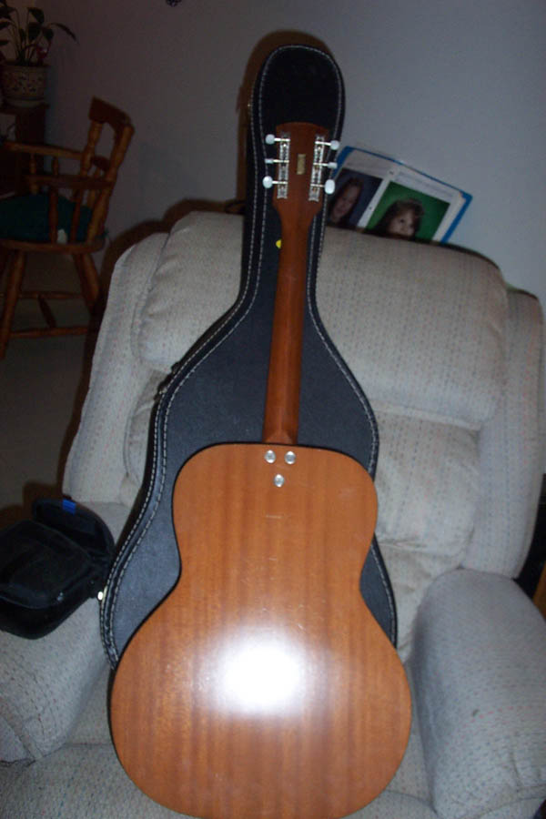

It is real similar to one my wife bought in the late 60's a Vox Serenader. Same factory I bet, but this one of yours has the K.
My wife's guitar has the bolt on neck through the back just like this. Her's is plywood all over. Is this one?
PostPosted: Sat Jan 07, 2006 4:41 am
Yes Dickey, it is plywood all around and can't see no serial number unless taken apart but wouldn't do !

Man, the bottom of the heel is sure a long way from the back.
PostPosted: Sat Jan 07, 2006 4:52 am
Posts: 575
Too bad yours is plywood, it must be a newer one then. The bolt-on neck ones must be ply.
Ron, the reason why there is no heel on the neck is because it's a bolt-on job. The necks attach just like a telecaster. The neck block inside must be huge.

PostPosted: Sat Jan 07, 2006 5:03 am
Yup, 21/2" x 2", quite a neck block!
