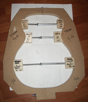

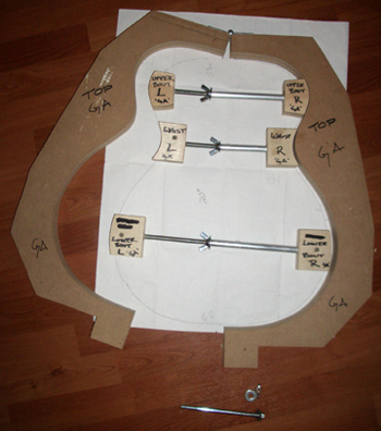

I just finished mine tonight. Waaaayyyy too long to finish it. Ugh. Long day finishing it up. A few rookie setbacks, but it is a modified version of Robbie O'Briens. I added a heavy duty hinge on top instead of another bolt-through hex head bolt. Mostly because I jacked up the mold to start with and didn't leave myself enough room for the bolt. The spreaders were super easy though, and work out great.
Its a happy accident for the time being. I only need to bolt on one side, now and it seems to work out pretty well. We'll see as I go along.
Top view of the GA outside mold.
Hinge Open version.
