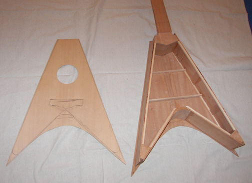

This is the work that I have accomplished so far on the project. As you might notice, I have picked mahogany for the back, sides, and neck. The top wood that I am using is Sitka spruce. The mahogany and spruce are both bookmatched, if not noticable in the picture.
Are there any more suggestions on tone bar placement?
Thanks for your help!

I would favor tapered/slightly curved bracing for the X, with the tallest at the crossing of the X, and with this size, about 1/2 inch high, 5/16" wide. I'd also make those back braces parabolic, down to under 1/8" where they meet the sides, and curved in cross section.

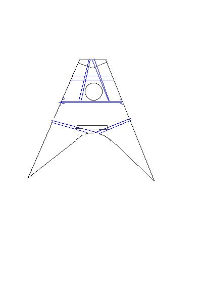

The inside of the legs of the V seem to be in almost the same position as the lower X in a more traditional guitar. I wouldn't bother with an X brace. Perhaps you can make an X using the V as the bottom half. In a traditional guitar, most of the sound comes from the area between the lower X braces. In your design, you have removed that portion completely. Many builders spend a lot of time tuning their tops by shaving the tone bar which are located in the area that you have removed. I'm not saying that this insturment isn't going to work. It's more like it's so completely outside of what we've all been doing that there is no guessing how it will sound.
There are almost no structural loads on the top in the V poriton and I wouldn't brace it there at all. I would put a light 1/4"x1/4" brace right below the sound hole and a stronger transverse brace right above the sound hole.
A potential problem with this pattern is that the bridge is directly on top of the X. It might require a lot of string movement to the any top movement. Perhaps this second pattern might work better.
In this design the corners of the bridge just nick the brace as it does in a more conventional guitar. The major area of sound generation would be above the bridge and down both of the V's.
Good luck.

Mike's right: with the bridge so close to the 'lower edge' the big problem you're going to have is getting some motion there. You coule make the top very thin with no real structural probem in back of the bridge.
How about a pair of braces that run up the middle of the two arms of the V and cross in front of the bridge? Make them very light below the bridge, and larger, say about 1/2" high or a bit less, where they cross. They'd come up on either side os the soundhole, ad you could put a transverse bar up top.
