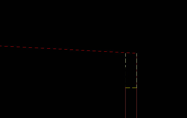

B, like John said, sure you can cut the ledge deeper at the bottom of the channel and scrape and sand to clean it up but than you would be left with several other problems.
First, the binding would not be sitting parallel with the side of the body, if the router were registered off the back of the guitar (assuming the guitar is built with a domed back). The dome of the back essentially is angled approximatly 4* off the perpendicular line to the side. You have now cut a channel which looks like this,
When you glue in your binding, you will have one of two problems, you will either have a gap at the bottom of the channel which you will not want to fill and you don't what to sand or scrape the side to make the binding parallel with the side, or if your binding is thicker than the cut you will have a binding which overhangs the side at the top edge, which will have to be scraped and sanded to become parallel with the side. You can do the second, but there is no garantee that the binding will be a uniform thickness once all the scraping and sanding is done. I know, the first three guitars were done with a lam trimer with the small guide roller attachment and the binding is all varying thickness' all over the guitar and is very noticable in some spots.
So if you cut the channel parallel to the side like this
you have a nice parallel channel to glue the binding into with very minimal scraping and sanding AND the big difference is that the binding SHOULD be a uniform thickness once the job is done.
Without a jig or binding machine, it is very difficult to cut that channel so it is parallel to the side for the entire run of the body. It can be done, but I don't know to many people who can look down the side, have a very steady hand with a tool running at 10,000+ rpm and keep the bearing parallel to the side while keeping the router base from sitting "flat" on the back of the body. It's just very, very tricky and a jig/machine takes alot of the trickyness out of the job.Rod True38723.5905439815
PostPosted: Fri Jan 06, 2006 6:11 am
I was writing and drawing while you posted. I hope this helps clear things up a bit.

You don't have to change the depth of cut once it is set to the binding height. See, what happens is this, there needs to be a small "platform" which the top or back rides against, this set the depth of cut into the body. Now, your not registering the width of the cut off the top, just the depth of cut. Since the cut needs to be parallel to the side (rib) of the body, the register off the top is a small footprint, just enough to hold the body from being cut to deep.
So again, you don't adjust the depth of cut once you've set it to the binding height.
I will take a bunch more pics tonight to help explain more.
