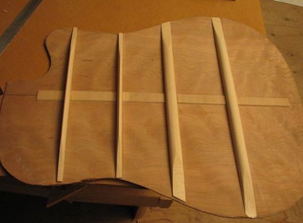

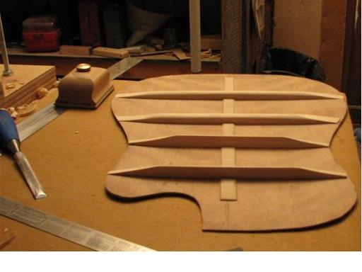

   Hello all, I'm still hard at work on number one... I've used the magnificient Cumpiano/Nathelson book. However, is it just me, or are these back braces too thick? Every guitar I look into doesn't seem to have such beefy braces (the two lower ones on the ladder). I'm just about to close her up so I would greatly appreciate your experience here. Thanks in advance.

IMOP the lower ladders a a bit much. More than double the upper. On a Dread I use .25" foot print on the upper and .38" on the lower. I don't think .44" would be eccessive but this seam to be aproaching .75" Th height look good on all.

   You're exactly right, .75. That's what Cumpiano recommends in the book. Or did I read that wrong?

No, you read it right. That's the 'old Martin' way of bracing a back, with the wide and low braces. 3/4" was right, but these are also tall, where they should be about 1/4" tall.
They look good, though; nicely done. You can leave them if you wish; these won't kill your guitar.

   Mario, I think I will shave them down a bit. As it stands the back seems to ring at an E (an octave higher than the top and sides). I'll let you know how it turns out.

seriously...yes shaving the braces will change the movement of the back and it's "pitch". It will also change yet again when the back is attached to the sides. The back does move and as a result, manipulation of it's bracing has an affect on much more than just the back. How much to shave, the shape of the brace, thickness, location, type ( "x" vs. "ladder" vs. "matrix" etc.) all make a difference. Some people believe the back should be as solid as a wall, others believe that it actually works in concert with the rest of the instrument. It's realy a matter of who you talk to and on what forum. If you realy want to understand more you need to take a course like the one Ervin Somogyi teaches. The topic is too deep to explain in a thread on this or any forum. Now, I'am gonna go lay low in my pool...it's at 89deg
p.s. as to what you have in the pictures...I would shave the heck out of them...the way they are now are much too stiff...IMHO of course! Dave-SKG38720.6079282407

   I will shave them down to about .25 tonight. I somehow knew/felt that they were too heavy.

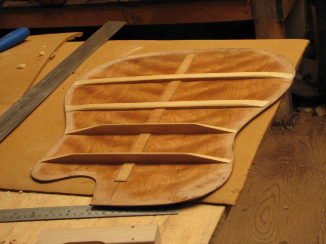

   A little elbow grease goes a long way. At the centre seam, they start at 3/16? doming up to just shy of 3/8? (say,... about 5/16?). I've also kept the tapper at the extremeties.
   I feel a lot better about it now.
   As for the change in pitch? Holding the plate up to my digital tuner, it used to ring at E. It would actually have a few different tones, but the predominant one at a wider variety of areas was the E. The pitch has now been lowered by two whole tones, (4 semi-tones) down to C.
