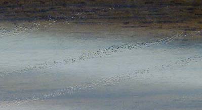

I've levelled/sanded and buffed out the KTM-9 finish on my instrument. After careful inspection of the surface (it passed!), I quit for the day. The next morning, I resume only to find several odd, curved lines perhaps 1/16" wide on the back’s finish. It looks like a finely blistered finish, but upon closer examination with a loupe, I'm somewhat certain that it's pitting, not blistering. The photo below is prior to buffing (the only good photo I have).
At first I thought that I could have missed the problems on the previous inspection. But, now I’m convinced that’s not the case. After a complete inspection in all kinds of lighting, more seem to be popping up in new places as I work on the instrument. The top has been immune, until yesterday that is, when several of those lines appeared there also (a couple of days after buffing). The sides don't show any of these marks - yet at least.
That got me to thinking ... the instrument has been mainly resting on the back, and rarely on the top the last several days. When not holding it during final sanding and buffing, it's been lying on the bench with a scrap of carpet on the benchtop, and an old (but laundered) sheet on top of the carpet. I also had a piece from the same sheet over the carpeted cauls of my body vise which I used when doing the sides.
Could somehow “something” invisible that can pit KTM-9 got deposited on the laundered sheets in the geometry of slightly curved lines about 1/16” wide? To me, it sounds a little far fetched. Does anyone know of a substance that might cause this on the KTM-9? Does KTM-9 react with DEET (though I have no clue on how lines of DEET would have become deposited on a laundered sheet)? Any suggestions on how to troubleshoot to help me figure this out so I can prevent it in the future?
Pete

My first though while looking at the photo is that the patterns seam to be parallel an not at all random. I would think that this is either cause by something it was resting on or something it came into contact with that would leave a foot print matching the pattern. Is there any vinyl around where the guitar was?MichaelP38720.5926041667

More information per your request:
1) The angles of the lines in general are random, though the ones in the photo are indeed parallel and at about 30 degrees to the grain. In other instances, they go across the grain as one or more lines, and in some places, with the grain. I did not see any correlation in the overall picture.
2) No vinyl around that I can think of. Would vinyl affect KTM-9 like it does nitro lacquer?
3) Pore filling was performed with ZPoxy 15 minute resin (all I could find in a pinch), and not the Finishing Resin most of you use. While I may have applied the epoxy at a slight angle, the squeegeeing off was done with the grain as that's what worked best for me.
4) The finish was brushed on with a foam brush. That went EXTREMELY well, in fact I was hard pressed to produce any bubbles at all. A sample of KTM-9 grafted coatings sent me a couple of years ago, was much more bubble prone, but that may have been the foam pads I was using to apply it to the relatively small test swatches.
Also, the finish was given a full month to cure before final levelling, sanding, and buffing. (3M Fre-Cut, StewMac Micro Finishing Abrasives, and Menzerna Fine followed by Glans Wachs).
Pete

Pete,
We sent an email out to you a little while ago. May be slow connection.
If possible, post a few more pictures as you mention they're more random areas as well. It may help give us a better idea or understanding of whats going on.
The picture supplied containing the bluish cast, would mean the coating was applied to heavily to fast or to many coats to fast without proper cure between. If 3mil wet was applied, it will leave 1.5mil - 1 hour under IR will definitely cure enough for next coat.

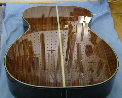

2) Regarding the effect from the carpet/sheet ... I really don't know. My last few sentences above, though, might indicate some involvement. The carpet is some unused carpet from when my house was built about 15 years ago. It's been rolled up in the basement for that time. It was rigorously vacuumed with a Fein Shop Vac prior to use. I have no clue what a carpet might exude, and if it still would do so after 15 years. Regarding edges, the carpet has a pretty thick nap (is that the right word?), so there are no real sharp edges. If it were pressure concentrated on the edge of the carpet and imprinting through the sheet, I'd expect it to be a lot more diffuse, and not 1/16" wide. Also, some of the lines go through the center portions of the guitar, and I NEVER had the instrument lying half off the carpet/sheet such that the carpet edge would be at the center of the guitar.
By the way, you see the line of white "trim" in the blue sheet (actually pillowcase) above? Thinking that might be the cause (it's about the right width), I placed one of my test swatches directly over that and weighted it overnight. No defect in the test finish this morning. But then, the test swatch is a couple of years old ... perhaps curing that long it would not be susceptible? Also I placed test swatches on that very same carpet/sheet last night, as well as contacting the plastic bottle that dispensed the KTM-9, and those did not come out with any defects. Again, the swatches were a at least a year old.
3) Regarding problems in the substrate ... there is a glue line down the middle of the back ... actually a whole strip of inlay. The defect lines appear everywhere, including across that. So it's not that. Resin in the substrate? Well, probably 100%, as I filled/sealed with epoxy. But maybe a cured epoxy is not considered a resin? Other than those two things, there is nothing that was done in the construction (intentionally at least) that would cause substrate problems where the lines actually are.
