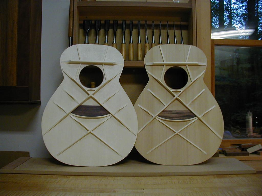

This is my first attempt to post pictures with my very limited computer skills-hope it works.
It seems there have been a lot posts recently about bracing patterns, so I thought I would add the two I am working on now. The one on the left is a Carpathisn spruce top for a 14 fret OOO/GC, the one on the right is a Port Orford cedar top for a 13 fretter.
I've only built one other guitar with double X bracing, but it turned out well so I think I'll stick with it for a while.

Very nice paul - can you tell us how do did the brace behind the bridge plate?
PostPosted: Tue Jan 03, 2006 3:43 am
Posts: 260
Lance - The brace behind the bridge plate is a bent lamination, three pieces of sixteenth inch spruce glued up on a form. I make the brace first and then fit the bottom edge of the bridge plate to it. This brace and the lower X are let into the main X brace.
I did this the first time on a guitar with a western red cedar top, thinking the curved lamination and the lower X brace would help protect the cedar top from bellying too much behind the bridge. And because I started life as a furniture maker I did it because I thought it looked good - I know, no one else will ever see it, but old habits die hard.
                        Paul Harrell

Looks good. Very similar to the pattern I use with the exception of that bridge plate brace. I have heard repairmen comment that braces like that make it really hard to work on the bridge plate should it need to be removed in the future. The idea is good but I don't know if it is necessary.
Very clean Paul!

Will the lower X brace cause a little too much stiffness and not allow enough billowing?

Like I said my bracing is very similar to Paul's. I don't believe the lower X brace will cause to much stiffness unless your braces are to big. Paul's bracing pattern looks nice and light (I really like lighter bracing, good job Paul). That brace behind the bridge may have some effect on the tone and Paul can hopefully chime in here. I am very pleased with the tone I get out of this pattern.
So what do your guitar sound like Paul?

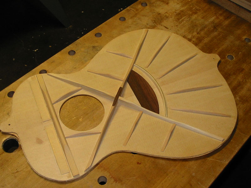

here's another deviation of a curved brace behind the bridge plate on one of my double tops.

That is an interesting variation Jim. What is the central wood you use in that curved lamination? What do you think about the tonal properties of this bracing pattern compared to more traditional patterns?

Josh - I have only built one guitar with double X bracing (a cedar and jatoba SJ fingerstyle) and I think it turned out very well - it has good balance and great sustain even high up the neck. But whether this is due to the bracing pattern or the phase of the moon when I strung it up, I don't have the experience to say.
I have used the curved brace behing the bridge plate on a number of guitars, but with traditional tone bars. I have seen on Mario's site that he uses a straight brace behind the bridge plate and swears by it, and I'm sure he would have a more informed opinion on what effect it has on tone. But so far, I'm a happy camper.
                    Paul Harrrell

The curved brace is a laminate of spruce .020 Carbon fiber and spruce.
It's hard to indentify tonal properties due just to the bracing as it's also a double top, but the guitar has loud well balanced tone. It's definately different and I like it a lot. I'm doing another one like it currently.
