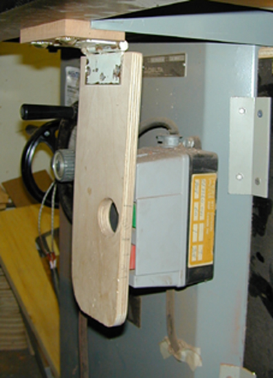

Might I ask what you are trying to kill here ??? I take it you are wiring this into an existing circuit, one with a mag lock relay switch on it ??? The typical kill switch is usually a simple momentary type contact that breaks the locking circuit on a magnetic set of contacts (relay), although some have the knob part of the switch lock into place until you pull it back out. It may or may not be running on 220V. The ones I make up from scrap yard parts are always 110 or 220 control circuits - saves you trying to get a 24v line just to run the relay.
I added a large 6x8 inch paddle of wood hinged from the top onto the switch of my unisaw - drilled a hole thru it to get to the start button, and there is a dowel on the inside of the paddle that just rests on the small stop button. So when at the saw, I can knock the paddle with a knee to stop the saw without moving my hands from the workpiece.

PostPosted: Wed Jan 04, 2006 2:14 am
Hi Paul,
Here is the add on i did to my Unisaw switch. I was thinking that it would be easy to be able to activate it from the other side (not necessary on a table saw, but more in your situation) either using a piece of rope/heavy twine that hangs over ot the other side, or a wooden lever setup - all that needs to be done is to move the paddle slightly in and it shuts off - you cant see in the photo, but there is a dowel right over the red off button so that moving the paddle in pushes that button - the upper hole allows access to the start button.
