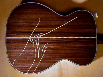

Over the weekend, I discovered I had what appeared to be new lines of blistering/pitting on my finish. In order to photograph them, I threw some masking tape, cut up in thin strips, over the lines. See below:

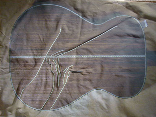

Then, without moving the sheet the instrument was resting on, I carefully took a couple of shots of the sheet with different light angles to bring out the wrinkles and the lay of the sheet. Then I superimposed that on the shot of the instrument. I think the answer is self evident!
I have no clue what the heck could be on the sheet to cause this, and I'll probably never find out. But I guess that's OK - I just need to prevent it in the future.

2) How would you suggest I fix the finish? I thought I could sand back a little, treat with alcohol, and apply more coats. At this stage (1 month +), the finish still responds to alcohol. If I swab some on, the gloss becomes haze, so perhaps with a sanding to remove the defects, and application of alcohol, additional coats of KTM-9 will adhere. Any thoughts?

Problem here is, if this was the cause, the lines in the back would be mirrored to the wrinkles, and not indentical, no?

[QUOTE=Mario] Problem here is, if this was the cause, the lines in the back would be mirrored to the wrinkles, and not indentical, no?[/QUOTE]
I believe this is an overlay image. I think the image of the back was mirrored prior to overlaying on the image of the sheet. or vise versa.MichaelP38726.4885300926

Mario ... good thought. The photo of the sheet is mirrored in Photoshop. Sorry I didn't tell you!

What is the sheet, then? What could be on it? Was it washed with fabric softener at some point?

Mario, those are just some old cotton sheets that my wife through in the washer/drier. I'll have to ask if she used any fabric softeners or "Bounce" in the drier.
