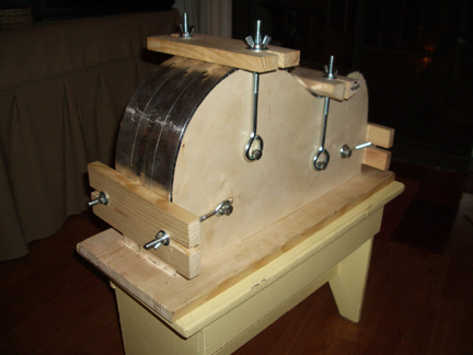

Not sure what "Style" this one is, but its from Robbie O'Brien's How-To Steel String DVD. It is for use with a bending blanket. This style is super easy to use. Highly recommended.
-j.
-jack handy

J. Brown, Nice looking Bender
I see the plank on the bottom. Does this mean you have to cut the side to perfect length before bending? Mine like this allows for them to run long and I cut them after the fact on the bandsaw.
Doolin starts his at the tail and bends forward, which is kind of cool. So many ways to do something. We find a method that we like and life is good, eh?

[QUOTE=j.Brown] Not sure what "Style" this one is, but its from Robbie O'Brien's How-To Steel String DVD. It is for use with a bending blanket. This style is super easy to use. Highly recommended.
-j.
Looks like the one that Sloane shows in his book Classic Guitar Construction
I went with something even simpler:
I use a clamp for that center caul, and have a couple of flat pieces for each end that I clamp in place. I use a thermostatically controlled heating blanket with it.

Dickey,
Thanks. I am happy with the way it turned out. Pretty clean, I think.
To answer your Q: No, the side doesn't have to be cut perfectly before bending. I left it about 3 1/2" higher than center of the guitar. This should allow for some operator error on the band saw and a little movement for corrections if need be.
-j.
