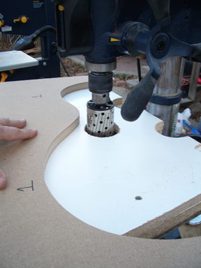

I just finished 2 different forms with it this weekend. Total of eight 1/2 guitar shapes. Used it with the "follower kit". It worked amazingly well. My router is out of commission, so this did the trick. It did dull after about 6, though. MDF and Birch laminate plywood. It is a great tool, but I am on my second blade refill. Cheaper than router bits, but longevity not as long. I do plan on using it for my bridges and bracing. Its a little more forgiving than a robosander and you really get the "feel" of it much more. I suspect it would do well with the hardwoods, but not thick pieces. Its really more of a finese tool than a workhorse, but I found it really fun and easy to use. It does not heat up very easily, so it really doesn't burn unless you press really really hard and its dull as heck. It was able to carve a stack of four 3/4" pieces. I pushed the limit, for sure. Now I know what it can and can't do. I highly recommend it.
I made my own table for it to attach to the drill press. Its hollow underneath to get the dust and such out of my way. It does make a really nice finished edge on it, too.

Thats exactly what I found. You can't force the wood into the blade or it doesn't last very long. The max speed on this rotary tool is 2,500rpm and they recommend 1,500-2,000 so it is relatively slow. Similar to the hand planes/rasps. I'm anxious to get further into the guitar to see where else I can use it.
