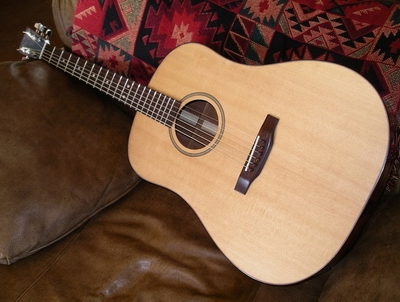

At long last I can post pictures of my first guitar to this forum. Its definitely a first effort, but it sounds better than any guitar I have ever owned.
It is made from the LMI Standard kit with the only modification being the rosewood binding:
sitka spruce top
sapele b/s
mahogany neck
EI Rosewood fb, headplate, end graft and binding
I started out the process using Cumpiano's book then got Robbie O'brien's DVD. I strongly recommend the DVD to my fellow novice builders.
I owe a huge "Thank You" to the people who contribute to this forum. This was my first real woodworking project and I might have turned it into firewood several times if not for the advice found here.

Very nice guitar Wayne. If you hadn't told us..I wouldn't have guessed it was your first. A kit is the best way to get started. It gives you a good idea of the fundamentals and what parts are involved. Now it's time to start one from scratch. Keep up the good work.

Thanks Hesh. I forgot to mention the finish.
I used the System 3 epoxy with silica for pore filling then brushed on KTM-9. I burned through in a couple of places when leveling, but I was able to repair it with more KTM-9 diluted with alcohol.
The humidity here is pretty low for this time of year. So far I haven't seen any cracks, but I am going to try one of those humidifiers that fit in the soundhole.

Really Nice Wayne
I love the look of the bindings against that Sapele, looks a whole lot nicer than my first
PostPosted: Mon Jan 02, 2006 12:19 pm
A whole lot nicer than my first try too Wayne!
Man, i should have went with a kit!
Nice combination for your first one and great finish also.
