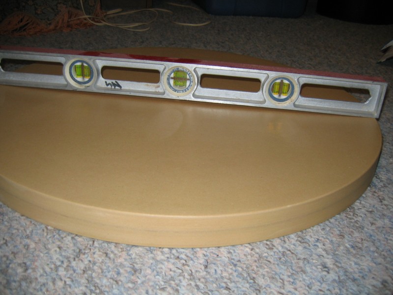

As promised - Our next auction is for a 30' radius dish donated by Shane Neifer of High Mountain Tonewoods
This dish is made of two laminations of ? inch MDF and has been finished with two coats of Varathane Diamond Coat.

As Lance said, 25' foot for the top of a steel string guitar and 15 foot for the back are the most common. On classicals, I have been told and will use on my next project, a flamenco, 30 foot for the top and 25 for the back. Having said all of this, some, as with Lance, use 30 foot for the top on steel strings as they say it presents a natural neck angle. I am inexperienced in this regard. I make dises in 12, 15, 20, 25, 28 amd 30 foot radii. I can custom make any radius also, I am making a 10 foot dish for a mandolin experiment for one of my customers in the next week or two. These dishes are double ply as I feel that they lend to better balance and stability, rather than adding the extra layer after the dish is spun. It adds a bit to the shipping (these dishes weigh about 16 pounds) but I think that the quality is what we are after. So the lamintation is done before the dishing process.
