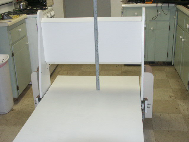

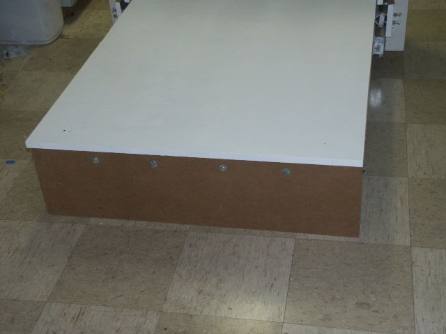

How does that saying go, measure twice cut once? Well I think I should have measured 4 or 5 times. I accidently made the gantry too narrow at the rails. I went ahead and widened the gantry since it would be easier to do than modifying the bed. Everything worked out ok and now the gantry is more rigid than ever. here are some pictures.
I still have to make a base for my machine and finish painting it.

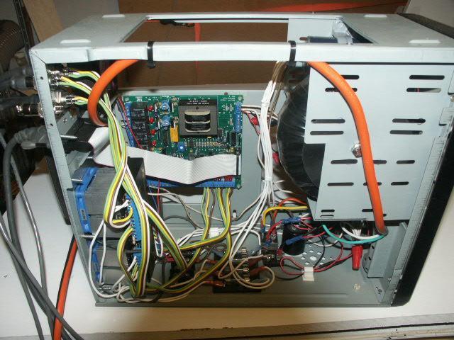

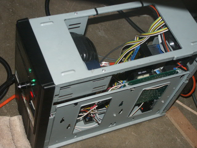

Right now I'm waiting for my Acme screw, they are not due in for another 10 days or so. Today I've been working on the electronic, I put them in an old computer case I had laying around. I'm going to finish up the Z axis (minus the drive screw) tommorrow.

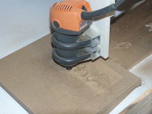

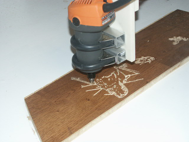

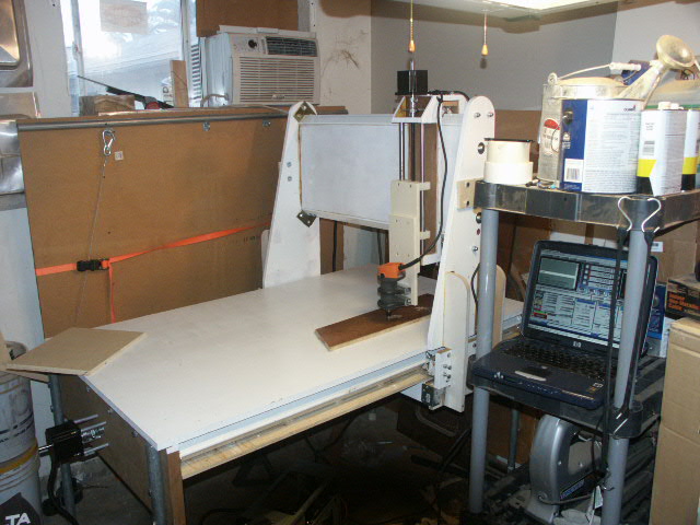

My machine is up and running! here are some pictures:
another,
Still needs some paint.

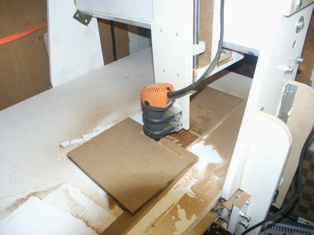

More pictures:

I'm still working on the finish details such as motor tuning, axis tuning and dust collection. I'll post pictures of the electronics in a day or two.

Jim, the machine is pretty loud while going. The noise comes mostly from the router and vacuum. I am able to get the machine going in the garage and go inside where there is little to no noise. I have some color surveilliance cameras so I'm going to mount one to the machine and then run the machine from the room next door, my clean room then I won't have to worry about dust getting into my laptop and I won't lose my hearing
Don, I will document my machine as soon as I learn cad a little better that way I'll be able to draw up plans and post them to the site. If anyone would like to build one they can just P.M. me and I'll supply them with info and detailed close-ups of the important details. I'm going to eventually rebuild the gantry with better sides. At this tiome there is nothing wrong with the sides it has but rebuilding them will make the gantry lighter without sacrificing rigidity.

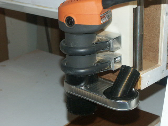

How do you like my new sardine can vacuum port?

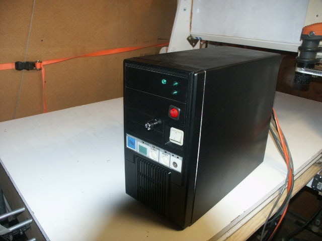

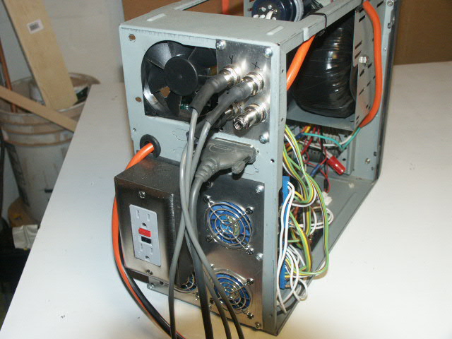

Here are some pictures of the heart of the system:
Here is a glamour shot, although it's not as sexy as John and Nelsons machines, I still like the way it came out.
