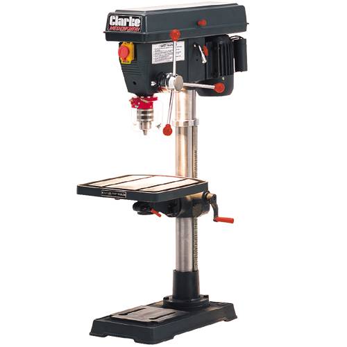

Bob this is the one I use It's a Clarke 401B, it's a big solid machine (as I said 67kg, 150lb) the head assembly is 71cm (28") front to back so it needs a deep bench, and I love it to bits, after my bandsaw it's the most used piece of kit I have and it replaced a floor mounted one which I found much less convenient. I use it for bobbin sanding, SafeT planer, disc sander all with dedicated tables and fences, oh and I drill with it as well. The problem is I'm in the UK so I guess you won't be able to get it in the US. But is the sort of machine I would recommend

That Clarke machine sure does look a lot like the Delta 12" bench top model that I have. It's a good little drill press. If I ever buy another it will probably be a radial drill press.
