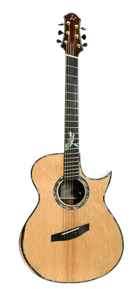

I have built played and own one ..my Dragonfly guitar, and am building two more like it, plus converting a 6 string biscuit reso into an 8 string ala CH, plus an electric CH like for a client. As well, my next personal guitar will be a baritone, 27 or so to 29 or 29.5, havent sat down to draw it all out yet (but the back and top are joined, and the sides bent !!)
Its a necessity when you are trying to use such variable string gauges, and a wide tuning range in order to get the thing to sound reasonable - how good would a low E off a bass sound at 25 inches ??? lousy. It needs to be in the 29 range at at least, and probably not with a 100 guage string either, more like 120 or 125. But at the same token, how does ahigh E guitar sound at 29 inches - way too tight and bright. its needs to stay around 25. So multiscaling is the only option to get it all together.
PostPosted: Wed Dec 14, 2005 1:56 am
here is a full frontal shot ...

The 'Novax' system has been around a lot longer than many think, it was tried in the very early part of the last century, Harry Fleishman did it before Ralph and calls his a variable scale guitar (or something like that).
I've built two guitars, the scale was 27" on the low end and 24.75 on the upper, for pictures you can go here and see the guitar: Guitar Gallery click on the guitars tab, you'll see one in there...
My fret angle is much more pronounced that Tony's but that was at the players request and I must say that it makes playing much easier. The hardest part is getting the saddle position set, you have to factor in compensation when setting the position.

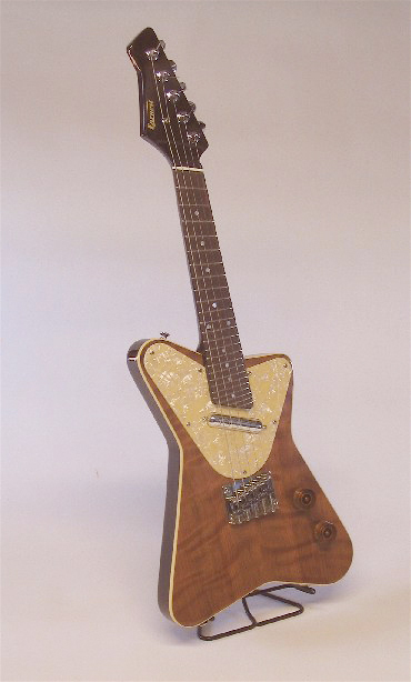

I play one of Joel Eckhaus' Boomerang 5-string mandolins with the Novax
fanned fretting system...
Five or ten-string mandos are notorious for not quite working, with the C
string needing a different scale length than the E....
This seems to solve the problem....
