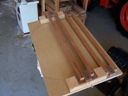

J. Brown, I don't know how close this jig is to the one Lance has, but it works very well. You can see two sets of guides, one for 28' radius and one for 15'.

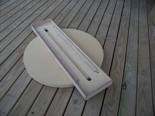

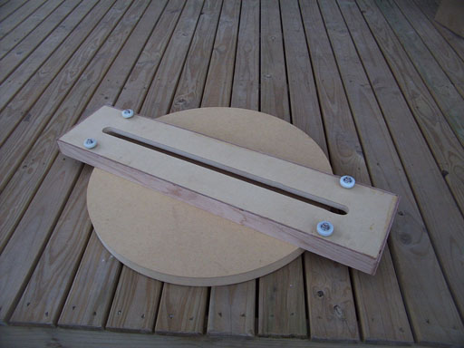

Ok here's some pics, I made mine a little differently in that I used a thicker base plate 'cause I've got a great huge lump of a (3 1/4 hp) router and I didn't want the jig to sag in the middle under the weight, I also made it wider to accomodate the router base plate, I just added the difference to the other dimensions. Also the wheels are a little larger in diameter 'cause they were cheap and suitable and right in front of me when I was in the hardware store - they were designed for sliding doors. The jig is a little rough by some standards 'cause I'm not one to make pretty jigs, if it works well that's good enough for me, especially if I'm only going to use it a couple times.
As you can see I don't have the radiused rails installed (or even made yet)but you can see where they're supposed to go.
Here's a pic of the underside, you can see how the wheels are placed in relation to the dish.

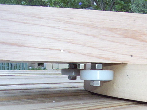

Here's a pic from the side showing how the wheels index against the side of the dish. I'm using 32mm mdf which is about 1 1/4" in the old money.
