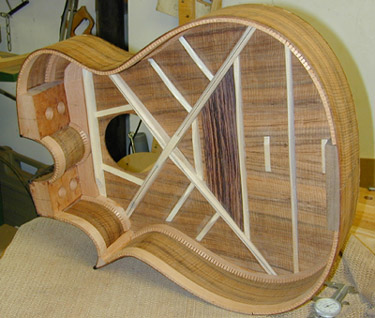

Here is the innards of the one I built ....

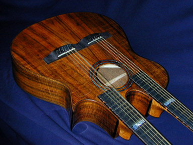

And here is the top view once completed.

So Tony, How does she sound? She sure is beutiful, that is nice lookin Koa (?). I am also using this brace system (Larrivee symetrical) but man you did a nice job! Is your cross laminated with carbon fibre or something?

It was jsut over for a visit last night, to show one of my students. He thought is was amazing. A lot of folks arent amazed by the sound, but by the playability of the 12 side - its like butter.
IMO it is a good sounding guitar, but in designing and building it, the first priority was for it not to explode once strung at concert pitch. We took the sound for what it was - I designed the whole thing myself, as far as the innards went, and I must way it turned out great. Its got PUs in her as well, the side mount Baggs with a neck selector switch (or is that a bridge selector switch !!) Baggs under saddles, the coax cable type. They were a bear to get sounding even across the strings compared to others I have used. The guitar is certainly not bass heavy, even though its a 16 3/4 lower bout. Its crisp and clear though, and he loves it to death.
The owner is in a BonJovi tribute band, and always wants whatever Ritchie is getting his hands on ( yeah and her too !!) to keep the band looing up to date. He only has 24 guitars, so hes halfway there !!!
The main X is 10x18 mm with 20 thou Cf in the midlle. Even with all that mite in there, the necks still affect each other when tuning up. Its kinda like a floating FloydRose type bridge without the whammy.

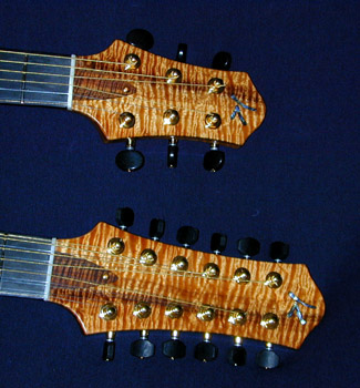

But one thing is for sure - you learn alot doing one. I thought I had the necks all set up, and then the client points out that the two headstocks arent quite even, one was a tad lower than the other. So I say, no prob, watch this. I do a few sandpaper pulls, and there it is, dead on. You could lay a ruler across one headstock face, and it just lays on its brother - beautiful.
