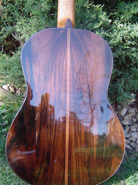

The product I use is from Europe. A company called ILVA makes it and they are in Italy. They also happen to have a Stateside distributor. It is a 2 part urethane.
I have used urethane for years and it holds up better than lacquer in my opinion. I am sure some would argue with that. I have also never had a urethane finish crack. If you are going for that aged look this is not the product. In the DVD I give contact info and instructions for using this product. I also show how to buff it to a high gloss by hand or machine.
Here is an example of the urethane on a classical guitar.
