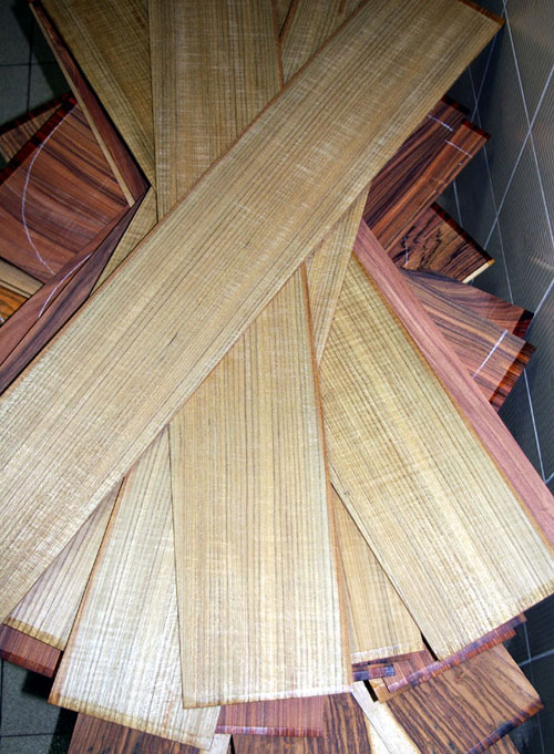

I bought 2 boards of this wood as African Teak. But, it defies most all of the characteristics of what I would expect from real teac. It's my understanding that most of the remaining teac logs are fairly small in size. These boards were 12' long, 10.5" wide and 2+" thick and perfectly quartered the entire width. This would indicate to me that it came from a fairly good size log. It's not heavy at all. It has been kiln dried and straight as an arrow. Resawing it was a breeze. It cut like butter. Sanding is very easy as well. I would put the working properties in a category similar to spruce. But, from my experience (which is little) and from what I've been told, teac is very hard and is supposed to dull tools very fast. I didn't find that to be the case with this wood. However, the one characteristic that does fit the bill is, it has a waxy feel to it. It also has a very unique and sweet smell with a very sharp tap tone. Regardless of what it is, I think it has great qualities for an instrument. So, it's kind of got me stumped. I tried to take a good close up photo of it so maybe someone could help me to clarify what it is if it's not African Teac. I've seen furniture and other things made from Asian Teac and this looks nothing like that. I know it's imported and not native to Brazil. So...anyone have any ideas ????

Well, this wood looks very nice. The real test, as you know, would be to build a guitar with this beautiful wood.
I would be willing to build one for you as a test model. and go from there.
Question: if it turns out to be an acceptible product, do you have plans to market this wood for guitar manufacturing?
Please advise.. Thanks for the picture!!
Walter
PostPosted: Wed Nov 09, 2005 1:37 pm
Posts: 267
Location: Brazil
Hi Walter...with my guitar building experience, I wouldn't hesitate to build a guitar with this wood. The tap tone is extraordinary. The downside is the wood is a little expensive..even in board form. But, when I tapped a piece I couldn't resist buying some. It has a soft flame effect throughout the board and very definitive stripes. Kind of a honey color and when I waxed the ends I was real impressed with the vision I had of a finished guitar. I do have plans to try and create a market for it but, I don't know if the market will bare the cost. We'll see. I'm just curious to find out what it really is and thought this was the best place to start. Maybe Bob will chime in and shed some light on the subject.

Dennis..I believe you're right. "Oldfieldia Africana" seems to fit the description except it's not as heavy a wood as they describe. These boards are fairly light in weight but, all the other properties seem to match. Due to the cost of this wood, I can't imagine using it in ship building. It would cost a fortune !! Anyway, thanks for the feedback. Ken...that's not purpleheart it's sitting on..it's Pau Ferro and BRW. I just cut a cubic meter of backs and sides and was waxing the ends. And had the Teac on top of the stack.

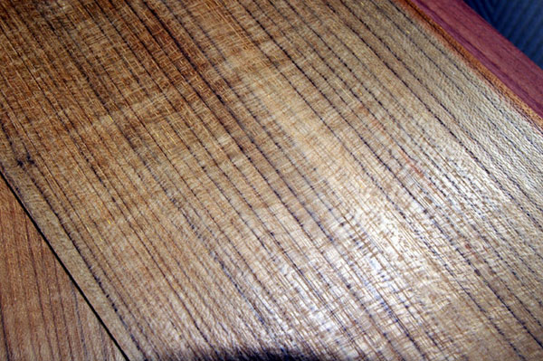

The neck and the outer laminates on this are Iroko, FWIW:
Mattia Valente38669.677349537

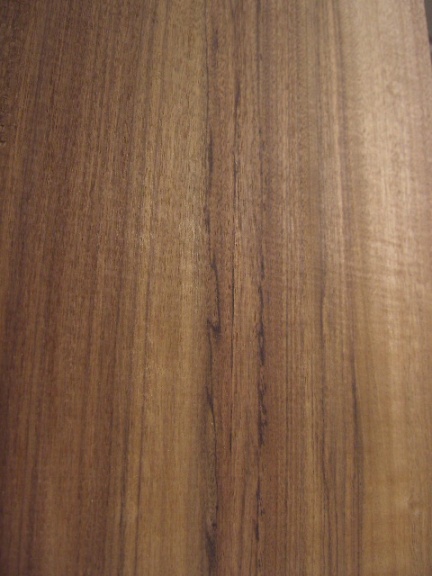

here's a picture of an Ovangkol plank I bought a couple of months ago. Colour looks quite similar, isn't it?
Luigi

Howard..it does have a yellowish color when fresh cut and does, within a day or so, turn a light brown. And Luigi..it does look somewhat similar to your example but doesn't have as much color variance as your example and the grain is a little more defined in this wood. It could be that this is just quartered a little closer though. Mattia..when you sanded the Iroko...does the dust become airborn?? When this is sanded it doesn't make airborn dust. It tends to stick together and hasn't been an irritant at all. It's a real stumper for me. But, all the input is appreciated. I think I will call the supplier I bought it from tomorrow and ask where it was imported from. That might narrow it down somewhat. However, they were very sure of it being named African Teak. In portuguese "Teca". Here is a set I just finished sanding. You can see the difference in the color of the sides and back. The sides were sanded out a couple of days ago. The back was just sanded today.
Irregardless of what it is...it's has a great ring to it and all the right properties for building instruments.Brazilwood38669.7332523148
