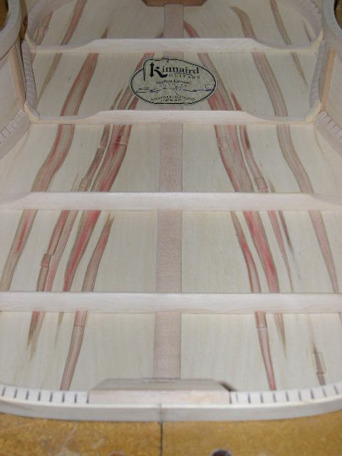

Slowly, ever so slowly, this guitar is shaping up.
It is being built with some Ambrosia maple from BobC.
What makes the pattern is the Ambrosia beetle, who leaves little holes behind him as he burrows into the wood. The resultant stain makes it worthwhile to me, but the holes need some treatment. Outside, I'm just about settled on filling them with some black goo. Inside? I decided to cleat them, and ended up using some off-cuts of the Am. maple. So here's a view or two of the cleating efforts.
Thanks for looking,

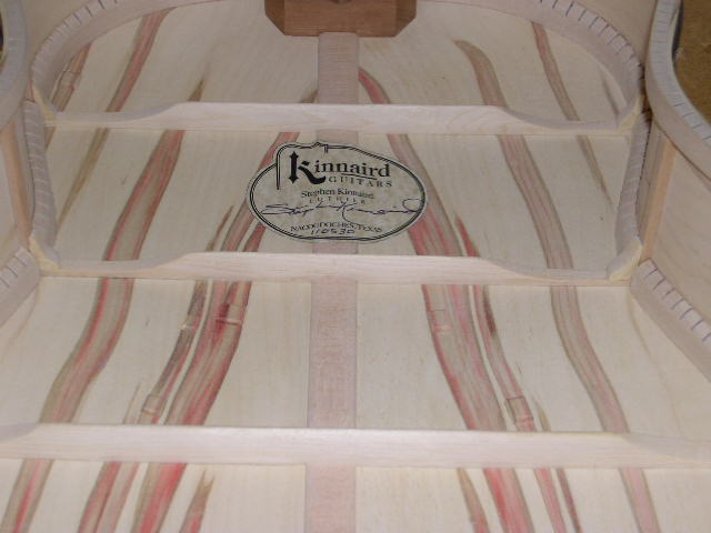

This one is simply from a different angle, showing a bit more of the work.
Some are easier to spot than others.
How many can you find???

I only see 9....But awesome job of matching Steve!

I'm with Shane - I see nine. Nice work. Can't wait to see it under finish.

Beautiful, Steve! I found 9...but I really had to look hard. Great job of masking...should be helpful when we start covering up the WFB cracks!

I've got 10 there Steve I think
1 Upper Bout Left
5 In the section aafter Label
1 in Next
3 in section by Tail.
Any way it is a work of art,

OK, I count 12...does the first to guess win when complete? I will PM you my address

Oh......I see 10 patches...

Hey thanks for the kind remarks, guys.
My brother got the correct answer!
No, actually, Russell and Don counted correctly.
But since Russell was first, he is the winnner!
The prize you ask, Russ?
It's not insubstantial. The first correct guess wins JJ's set of Waterfall Bubinga! I'll send along his email address so you can contact him with your shipping details.

Steve - that is as cool a guitar box as Ive ever seen! Id love to see it from the outside sometime

I've never seen ambrosia maple with that much red. Reminds me of box elder. It's very nice!
PostPosted: Thu Nov 10, 2005 4:47 am
Ron, you are correct. At least that is my understanding, that this set is indeed Boxelder. It is very soft, and sort of "punky" like Poplar can be. But the coloration just got to me, and it was crying out to be made into a guitar. We'll see how it works....

I really love that look. The interior might be as pretty as the outside.
